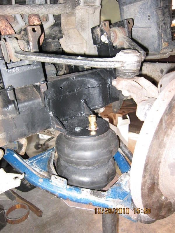

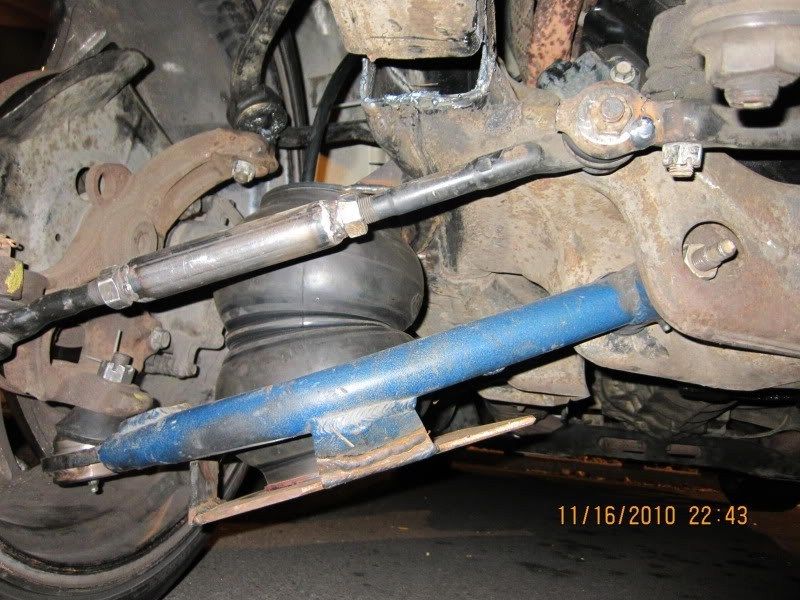

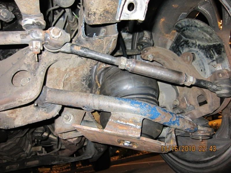

I didnt mean to imply you did it wrong. You just did it alot different. If it works, then thats great.
I was pretty skeptical of switching the arms when I first thought about it 4 years ago. But figured it was worth a shot. So when the guy that had this truck before me tried it out when it was in our shop, we decided to try it and if it didnt work good we could just put it back.
bagtodrag's avatar
bagtodrag

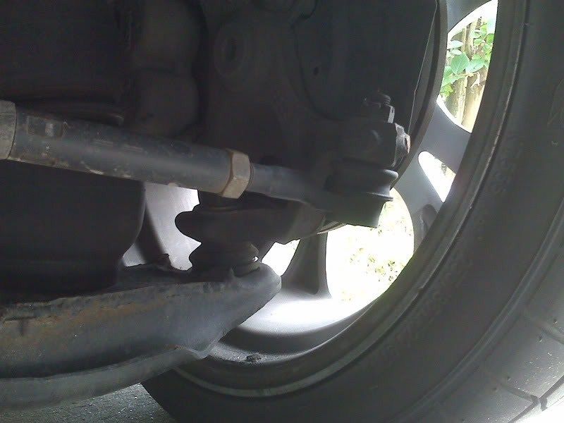

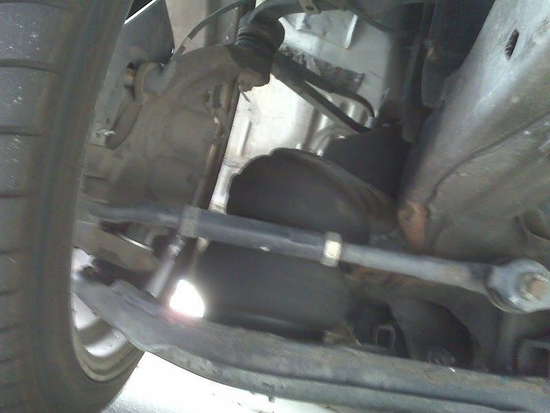

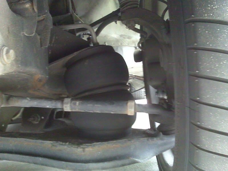

I just noticed this but your ball joints are at a bad angle when lifted, looks like they are fighting each other bad. These are pretty old pics but its when I had mine done. Also, how are you tie rods longer? Thought they are the same length for every 97-03?
All my arms are being redone with custom tube uppers/lowers now.
medicus's avatar
medicus
im with bagtodrag your ball joints look to be seriously binding and your bags arent even maxed out yet
