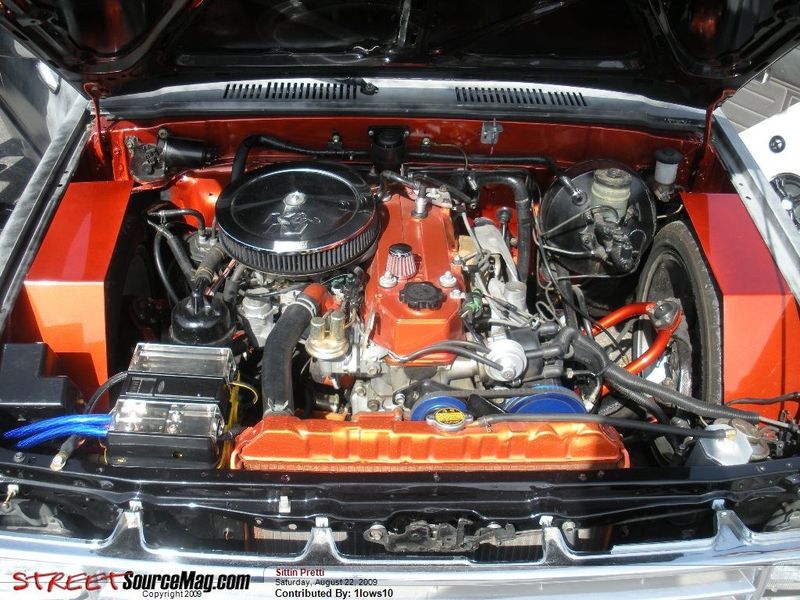

i'm getting kinda burned out on seeing this topic over & over (no offence dragitall) i only mean that cause no one ever seems to listen to me or bobby.  YOU DO NOT NEED TO Z ANY TOY'S OTHER THAN NEWER TACOS!!  feel free to im me or bobby & we'll put you on the right track.  whether you listen to us or "the other guys", if it's a money issue...you're just going to have to wait.  either way requires some minor cutting & welding.  you can just slightly rework the lower frame spreader bar & crossmember mounts where your lower control arms attach.  trust us, it IS possible & my stock hood closes without lowering the motor with a traditional 2.5" body drop.  anyone who says it won't lay flat out, or it will look funny is just plain wrong!  here's a couple pics of mine to prove it.  keep in mind that you don't NEED tube arms, i just chose to make them for looks ONLY!!

by the way, mine is just past the pinch so it lays flat rockers...
