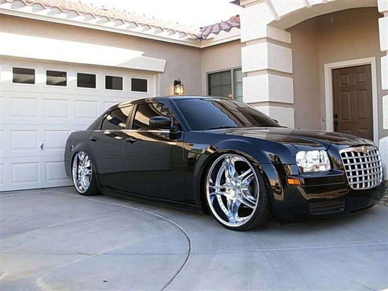

someone say 24s????, here is a 300 I did on 24's.
lilbuddha
your a jerk tre
