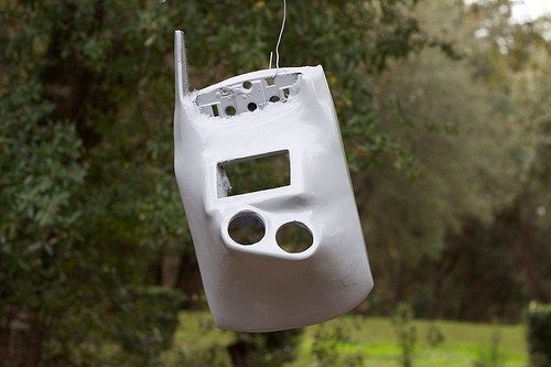

That's nice. I need a set of 95-96 mirrors. Here is the front part of my console. The armrest portion, I am leaving stock, I just chopped up the front section up and glassed it. This is right after I sprayed it with primer. I blocked and sprayed it. The paint is drying now, don't have a pic yet. I will be putting it in tomorrow.

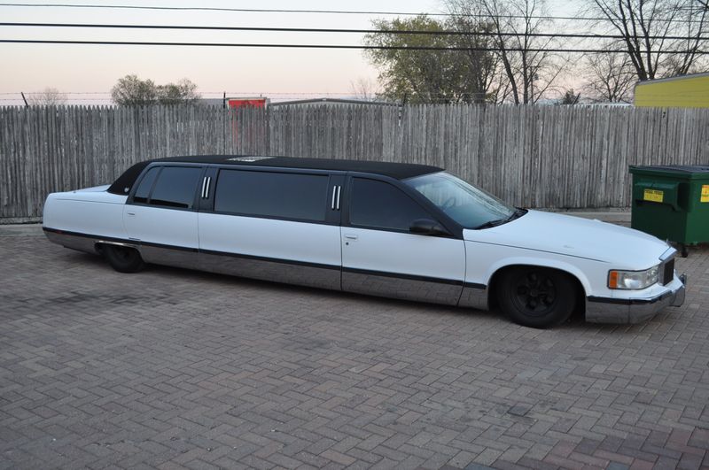

good luck on the project. Love cadillacs on air. we just did a fleetwood limousine for my buddies wedding.

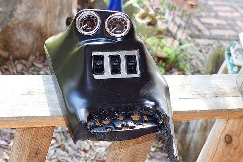

Yes they were. That's why I will never heat springs to lower a vehicle. That limo is slick. Here is a shot of my console assembled and ready to be plumbed.
