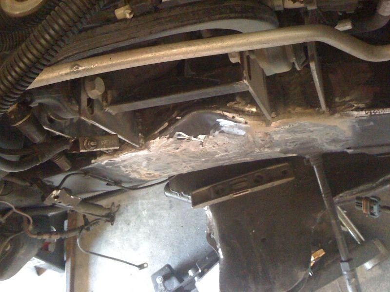

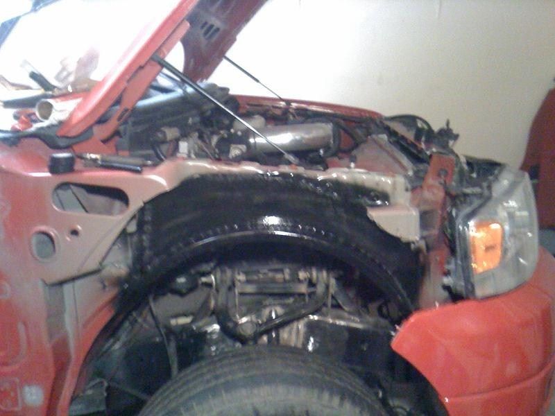

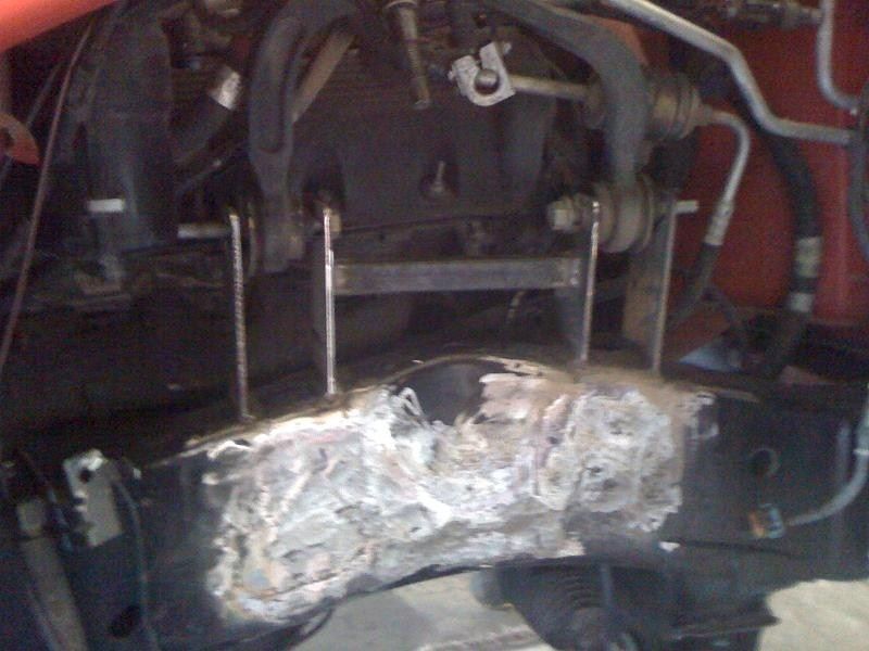

  Filled in the holes in the frame and mounted fresh tabs on there

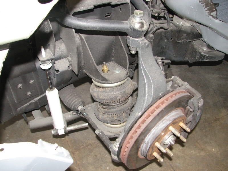

drgn91yota's avatar
drgn91yota
lets see a pic of that mark lt laid  out

speedyredryder's avatar
speedyredryder

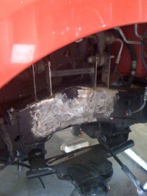

 Holes sealed before bag braket new tabs in place
speedyredryder

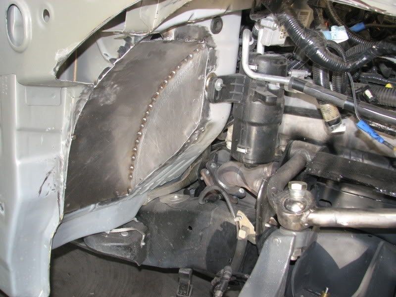

 Side of tub with filler plate tacked and sprayed
speedyredryder
 and Top of tub tacked an d sprayed onlything missing is seem sealer
