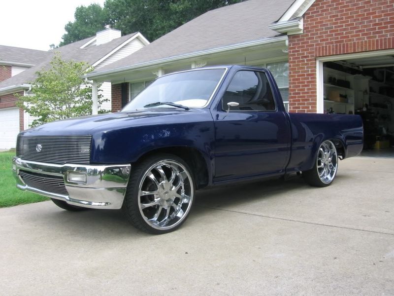

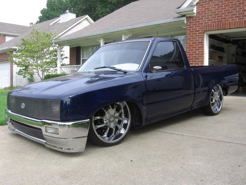

the blue yota in my profile lays crossmember on a pretty decent sized 18" tire. Stock arms, and spindles, no issues with tie rods.

--------------------------------------------- Originally posted by iLLblazer the blue yota in my profile lays crossmember on a pretty decent sized 18" tire. Stock arms, and spindles, no issues with tie rods. --------------------------------------------- no z?   I'm not running bags in the front.  I've got a cylinder that I'm putting in.  I'd have to go back and check again and take some pictures of what I'm talking about.  But you're saying this blue yota on your profile lays crossmember on 18's?  The front crosmember under the engine?  What size tire do you have?  I see you didn't do anything with the strut rod going to the lca.  It doesn't hit the steering arm when all the way down and prevent turning a lil'?  I'm probabaly going to run 225/40r18's.  I might be trying to go to low  with my arm movement.  I'll try and mess with it this weekend.    slammedtoys sorry if I came back as an a**.  You're right I might be worrying about something that may really not be an issue.  I'm just in the planning stages of the front.  Like I said before, I noticed something, had a question, and thought I'd ask others who have done this more than I have.   Thanks guys.
