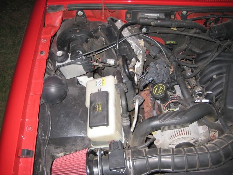

tmiit71's avatar
tmiit71
Edited: 1/10/2009 9:26:25 PM by tmiit
<a href="http://s71.photobucket.com/albums/i156/tmiit71/?action=view&current=IMG_0179.jpg" target="_blank"><img src="http://i71.photobucket.com/albums/i156/tmiit71/IMG_0179.jpg" border="0" alt="a/c view"></a><a href="http://s71.photobucket.com/albums/i156/tmiit71/?action=view&current=IMG_0180.jpg" target="_blank"><img src="http://i71.photobucket.com/albums/i156/tmiit71/IMG_0180.jpg" border="0" alt="a/c view 2"></a>
