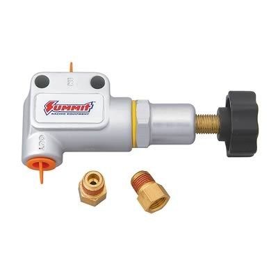

It is nice but will it have the same thread type and size as my brake lines? Probably just for domestic vehicles.........Speedway motors one>>

thatll work. i used something like that on my 62 falcon when i put 4 wheel disc on it
those come with 1/8"NPT ports,so you'll have to get an adaptor fitting. I just put one on a '34 Ford truck that I'm building.

many people say they're fine with a "T" but i wouldn't trust my life (or anyone else's) off anyone's word. under normal driving circumstances with a "T" you'd be fine, but completely removing it creates a safety issue because unexpected rear lockup/fishtailing is just flat out dangerous (& ignorant) when it can be fixed with only a $38 part.
see that's a load sensing valve that opens more as more weight is added to the bed & by completely removing it, you're giving it full fluid flow & pressure at all times. adjusting your shoes might work, but when you go to an empty parking lot to test out how much adjustment they need (by doing mid speed hard braking tests) it'd be easier to turn a knob, then remove the wheels & drums. with the adjustable valve, it can be done in about 10-20 hard lockups which is about 1-2 hours.
here's what i used:
http://store.summitracing.com/partdetail.asp?autofilter=1&part=SUM%2DG3905&N=700+4294922533+4294918719+115&autoview=sku

also you can get the fittings for less than a dollar each from almost anywhere...napa, grainger, industrial hydraulic supply houses, etc...
here's what i used:
totally agree bro, thats why I started this thread. SAFETY

i mounted mine on the inside of the frame rail & just cut the line where i needed it. here's a couple flare tools that are pretty cheap & then you don't need adapters at all. i just went ahead & used 1/8" flares & brake line flare nuts...
sorry if i sounded rude, just people removing safety equipment bothers the hell out of me (airbag steering wheels are ok though )
http://store.summitracing.com/egnsearch.asp?N=700+4294925139+4294925137+115+4294909979
http://www.harborfreight.com/cpi/ctaf/Displayitem.taf?itemnumber=40878
http://store.summitracing.com/egnsearch.asp?N=700+4294924496+4294846156+115+4294842775
i could be wrong about that part number for the flare nuts
