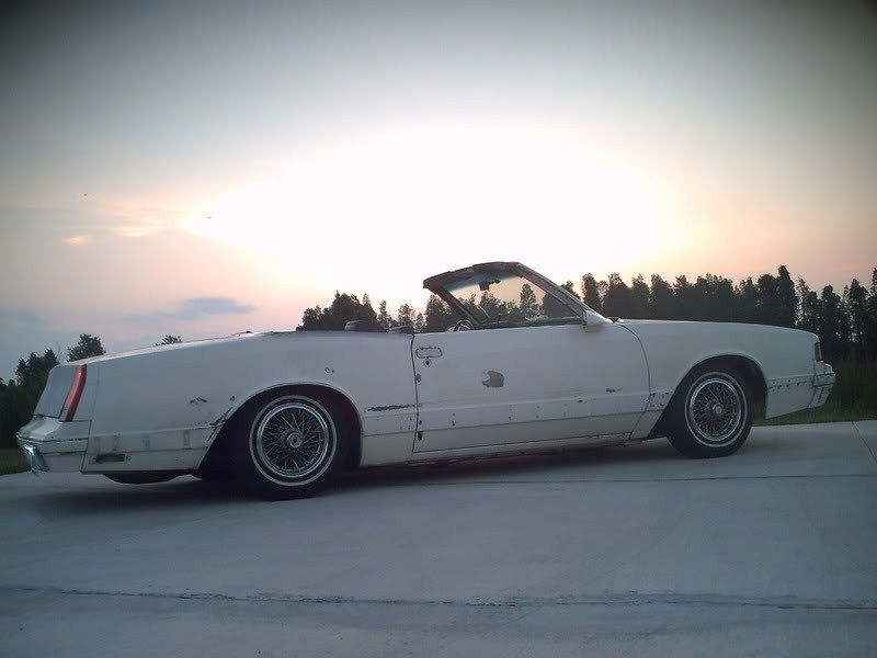

Choping it off didnt take long at all, its getting it capped off and looking like it was made that way thats taking some time.I also plan on reinforcing the frame so it doesnt flex so much.Also dont try to cut it the first time at an even body line. Its better to not cut enough and trim it then to cut too much.
