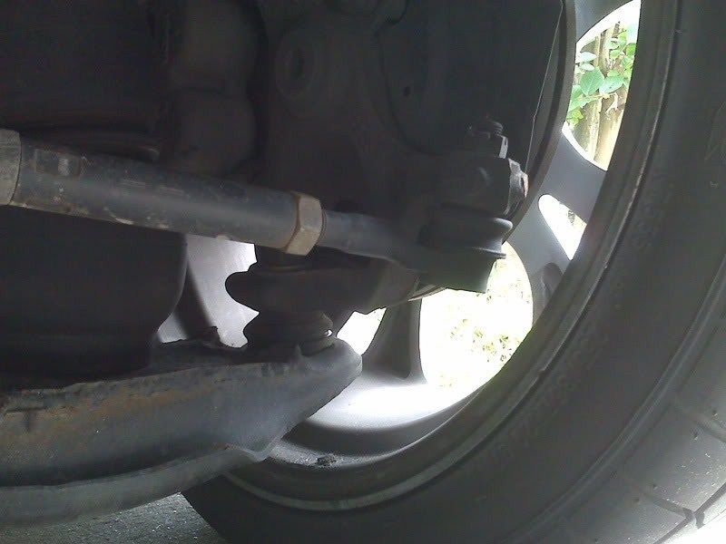

Originally posted by bagtodrag
flip lowers replace balljoint with chrysler cordoba, flip tie rods & raise uppers 2in. You could also swap uppers left to right & right to left to help with firewall clearance if your gonna run a big wheel and tire combo. Just use all your stock parts.Pics from my truck...
Explain this a little more. How would that help with firewall clearance? and not affect geometeries?

it helps with clearing the brake booster more than anything cuz it reduces camber but to lay out you will need to relocate the wireing harness
