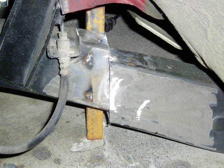

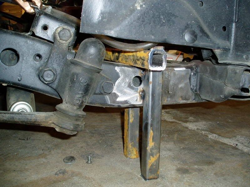

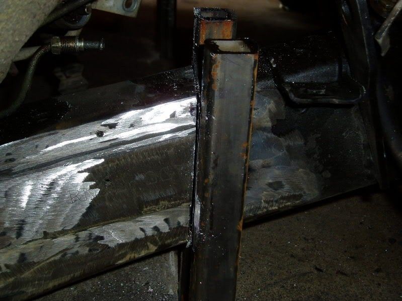

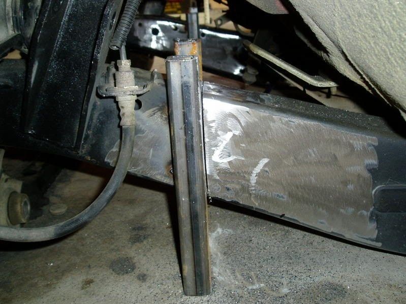

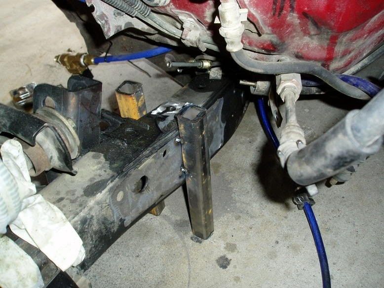

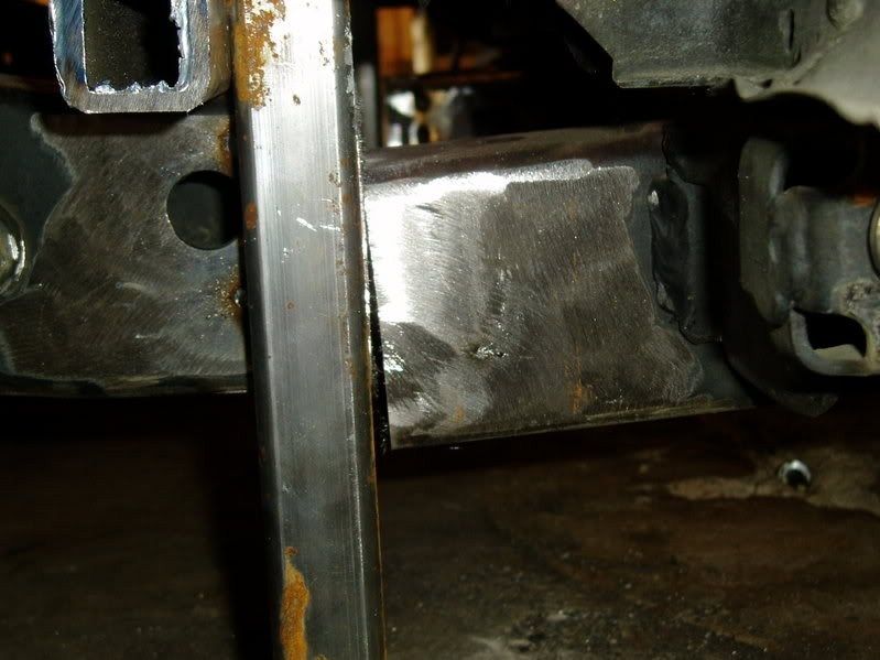

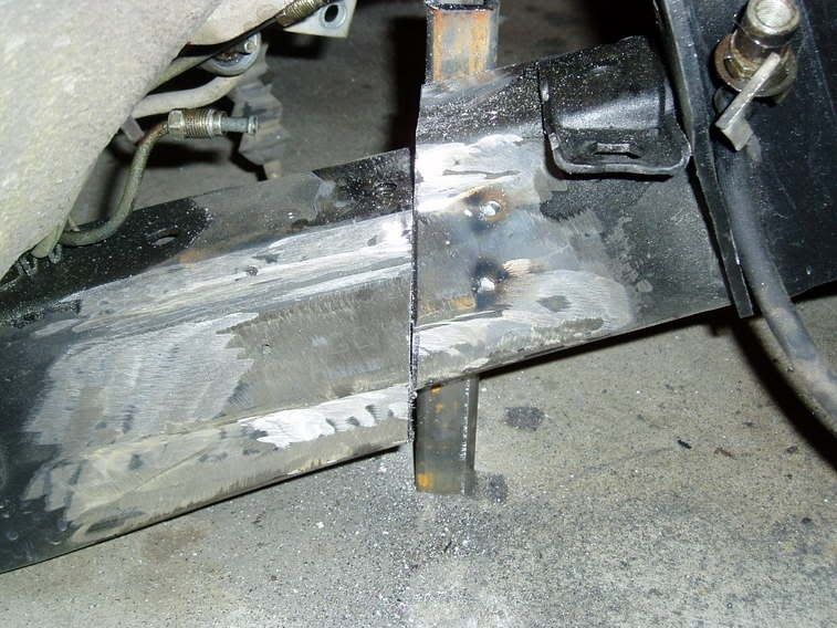

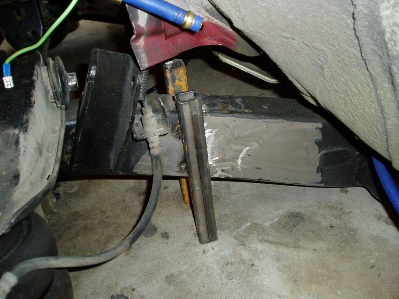

When i did my Z i did it on my garage floor, no marks, no lines, nothin! LoL My motor was out (for rebuild) so it made it easier to weld the plates on the inside of the frame. You should still be able to weld the plates with the motor in the truck. Here are some pics of how we did it.
Get some 1x1 and cut some pieces long enough to weld to the frame and touch the ground. you do this so the front clip of the frame doesnt move front to back once its completely cut.
Once thats done at all 4 corners of it then start cuttin them. The 1x1 also acts as a guide for the sawzal to cut a straight line.
Make sure you support the rest of the truck BEFORE you cut so it doesnt drop on ya once the front clip is free from the rest of it. We used scissor jacks (its a bitch i know but it worked hella good.LoL)
Once its all cut now you can lower the rest of the truck down so the front part after the Z hits the ground.
Once its dropped start welding it up and weld some plates on the outside of the frame rails.
If the motor is still in it i would lower it first because there isnt much room at the tunnel for it to go up when the rest of the truck is lowered down. If you plan on doin a bodydrop to it also it would be the best time to do it once the Z is done that way you dont have to do the front part of the frame twice.
