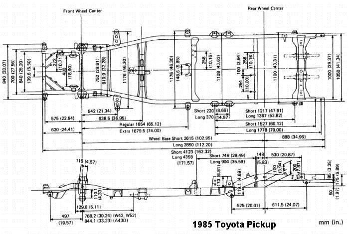

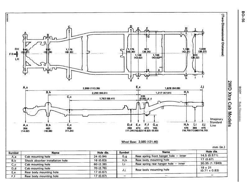

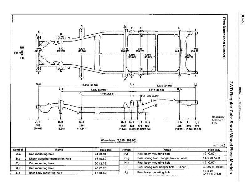

I have been using these to draw up my chassis, so they may come in handy to others.
