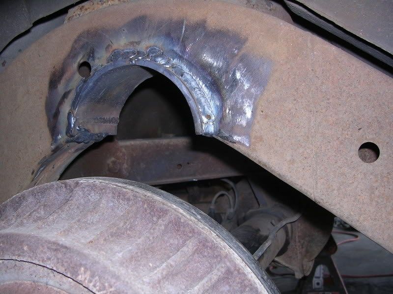

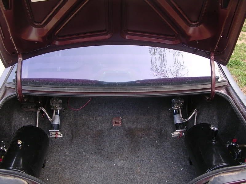

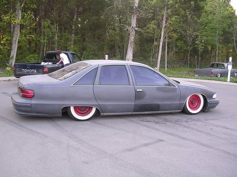

we did a buddy of mine on a 26in tall tire. stock everything and it just misses the ground(out .5in) which he's happy with.

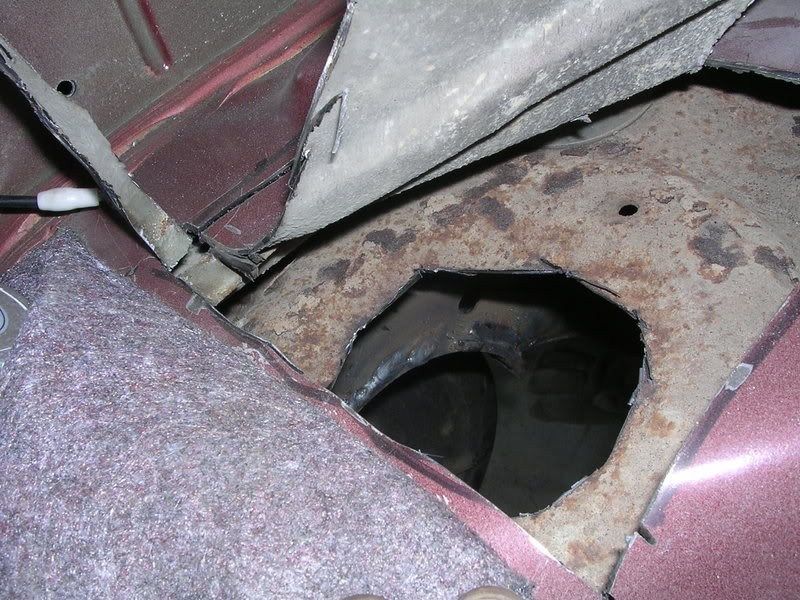

in the rear we took a 5in tube cut it in half and made a small c-notch. put axle perches on it and i welded a plate to the stock upper spring foot to bolt the bag to. if you cut a access panel in the back behind the seat you can get to the top of the bag this way.
the front is all stock with a cut pocket and notched tierodheres a couple pics
