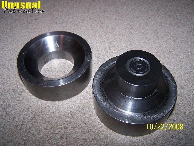

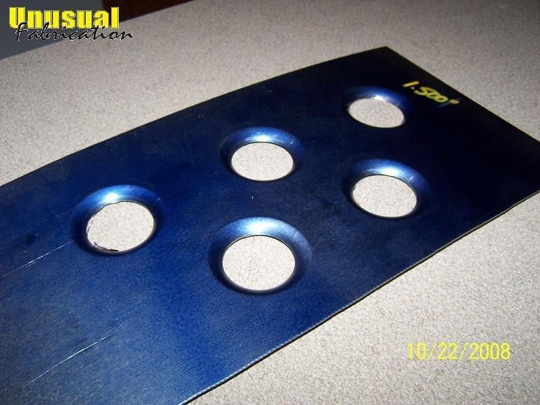

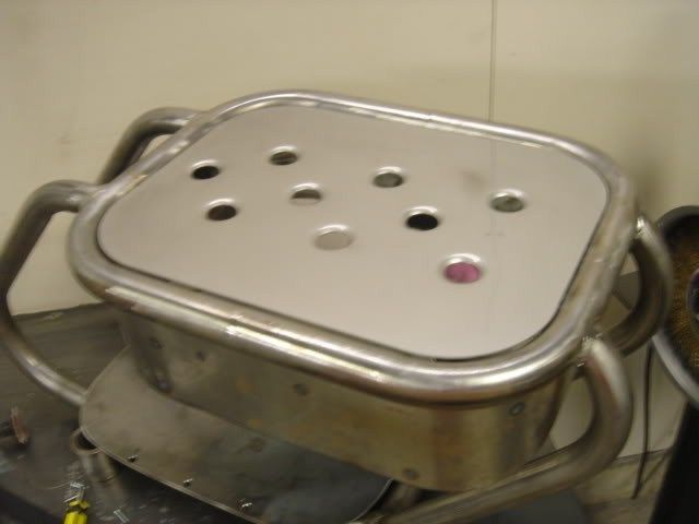

unusualfabrication
Heres a couple pics of the pair of 1.5" dies I made and a piece of stainless steel that I dimpled.
ahab
How much you chargin for a die like that. Im interested
AVTekk
nice, looks good man

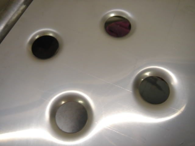

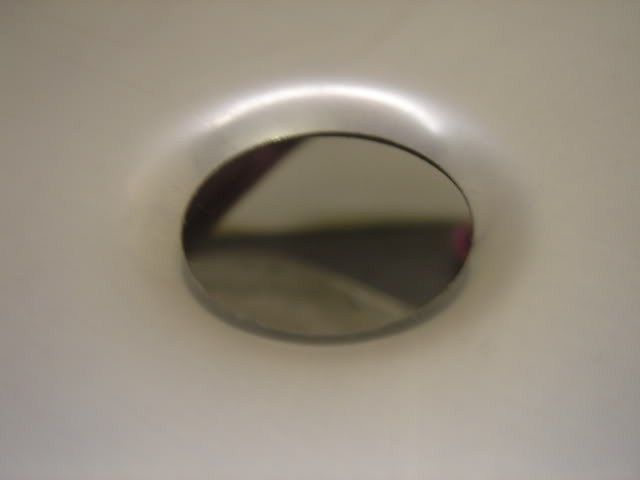

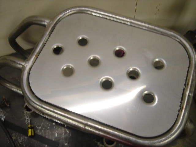

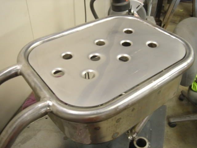

jeebus @ mmw
Heres the product of the set i made...
