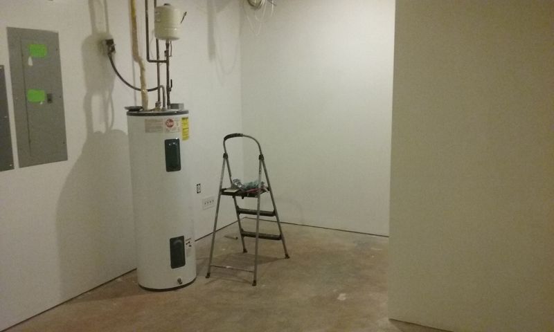

Has anyone had a good experience with coating their garage floor? I'm leaning towards the Rustoleum product but from the reviews I read, seems like it doesn't cover well.
Going to start with this storage area first,going to be a pain to clean.

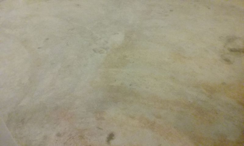

Here are some pictures of the floor clean, and ready for paint. There are still some stains in spots but this is what we did.
1. General Sweep and Vacuum
2. Whole floor scrape
3. Wire wheel on stubborn spots
4. Spot treatment of oil and other stains
5. Two rounds of a complete floor cleaning with Degreaser and scrub brush
6. Two rounds of a complete floor cleaning with the concrete etcher and scrub brush
7. Two rounds of rinsing with clean water and a scrub brush
8. One final rinse with clean water and a squeegee
9. Sock Test, Brandy danced the night away in white socks to see if the floor still appeared dirty. Luckily it passed!
10. Complete wipe with tack cloths
I forgot to mention, also did the moisture test which involved taping a 2'x2' square of plastic over the concrete and letting it sit for 24hs to check for moisture. No moisture was found and there wasn't any discoloration of the concrete to indicate moisture.

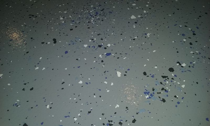

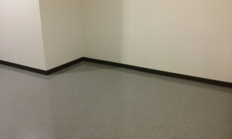

Some progress pictures, it's still wet in the pictures. After this cures, we'll be adding a clear coat.

Thanks! I'll have to keep an eye on that. I'm hoping that it's able to bond well by doing the cleaning, the concrete etch seems to work really well, much better than the degreaser.
Once this is cured, I bought a clear coat to put on top. It might be over doing it but it should look pretty shiny.
