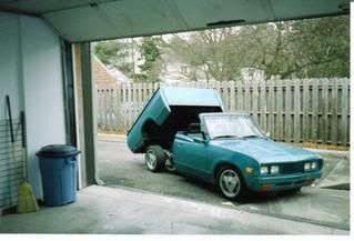

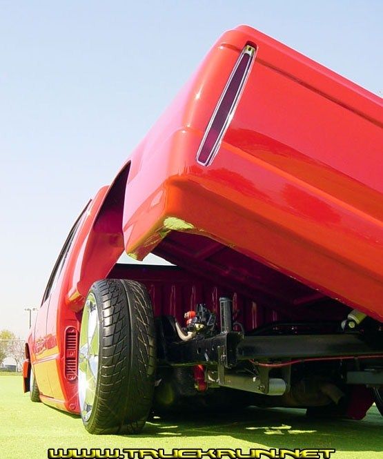

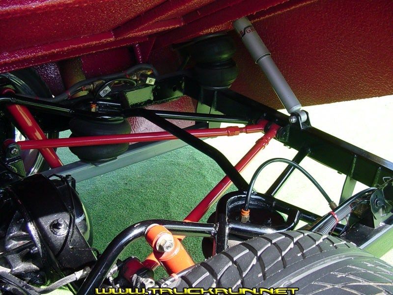

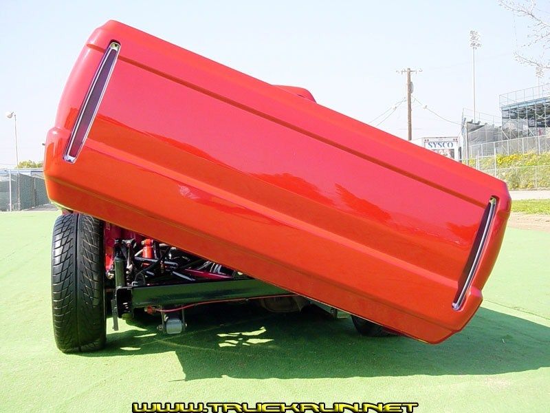

baggedmitsu
shavenotbagged
Hmm so its nto really that hard but 3 questions do i have to make a sub frame for my bed, caue ino when icut it out its gonna be wobbily as fuck m and how do you get it to lock in position , shokcs be recomended or no
baggedmitsu's avatar
baggedmitsu
mine had a cadillac trunk latch that was electric to lock it. when i hit my switch to the bag a relay sent the signal to the latch first then the bag. i had a shock on their to stabalize it. i could 90 mph down the fwy with a load and it was still as could be. My trucks bed was fully sheeted so it was subframed.
