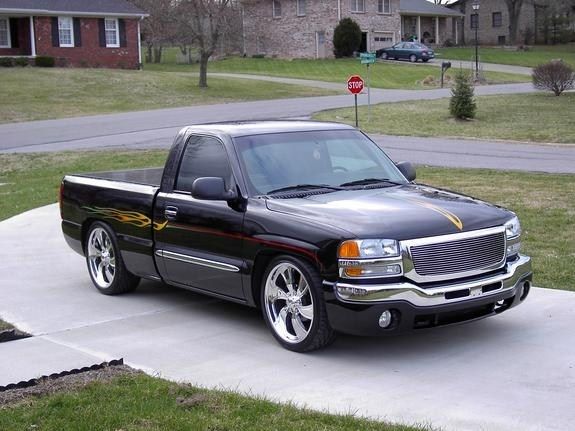

Here's one of our customer's trucks... 4/6 DJM with 22x10 with 7.25" backspace and 285/35/22 tires.
Another customer's truck, this one on 22x8.5 and 22x10 with 265/35/22 and 295/30/22 tires... drop is 5/6 via BellTech.
