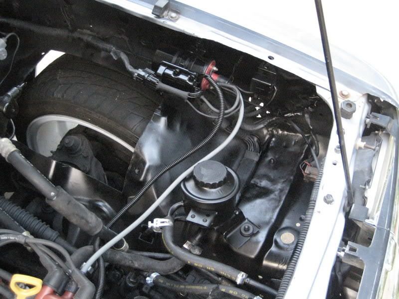

This is the only pic Ive got at the moment...Ill get some new ones of the MSD coil soon, but you can see in the pic that Ive got the round style coil on my truck. All I did was swap out the factory one for the MSD-(looks just like the factory one) then I hooked up the positive & negative wires, plugged in the ignition wire that goes to the distributor & was done.

So the msd coil is a bit better then stock. and you kept the ignitor and attached it to the side, right?

Yes...kept the ignitor & just swapped out the coil. The idea about using the V8 set from Taylor wires is a good plan too. Ive done that before with the V8 wires from Accel.
