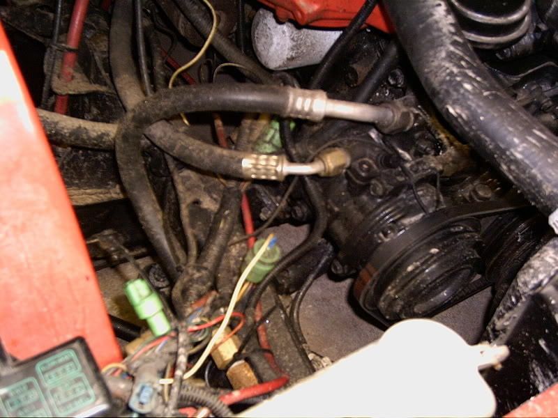

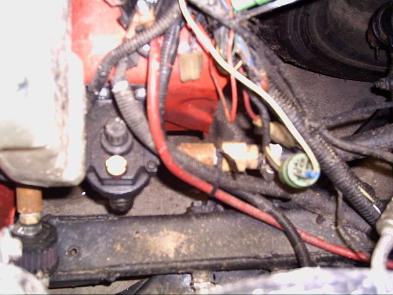

its really easy to do, i've got a couple pics here to help. don't mind the dirt, not having inner fenders suck!!
You have a high ( pressure/ exhaust ) and a low (suction/ intake) side on you compressor. The diagram will go something like this.
filter > inline oiler > ( to the compressor) > intake/ low it then exits the compressor on the high/ exhaust side >check valve > water/ oil trap > tank
Top pic is of the k&n filter then the oiler. Second pic shows the line running from the oiler to the compressor then exiting the compressor to the check valve and tanks.
I used a check valve for extra insurance just in case. you will need the oiler or go through the hassle of adding oil to it every so often. Since there is no freon, there is no oil to lubricate the piston in the compressor. The water/ oil trap will keep your tanks and valves from getting the excess. I have my compressor connected to my pressure switch with a manual overide. At idle ( 900 rpm ) and 0 psi it takes a little over 1 minute to fill to 130 psi. and 2 minutes to shut off at 200 psi.. Very seldom do I let it fill past 150 psi since it take 80psi to fill the front and 65 to fill the back for high ride height. And I used the original hoses, I had the one shortened by about 6in. plus had a new fitting to work with the pipe threads on the oiler.
