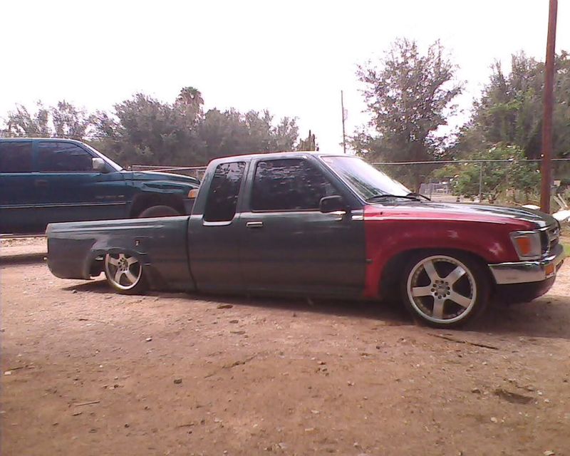

What is required to install a 4runner gauge cluster with the tac and all in a pickup with only the fuel ,speed, and temp? I tried to search but couldn't find what I was looking for.

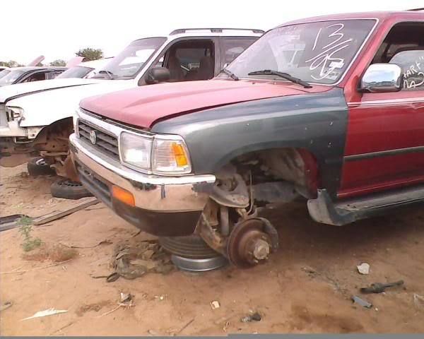

Sweet, mine is a 93, but if I am correct, last time i took the cluster off it was electronic. I guess im gona head out to the junk yard and see how much they want for it.lol Man im gona strip that 4runner I found.lol I already got the fenders for trade and 50bucks, and he said he would sell me the complete bumper for 55!!
Hmmmm..... Im feeling a 4runner front end swap coming soon....
