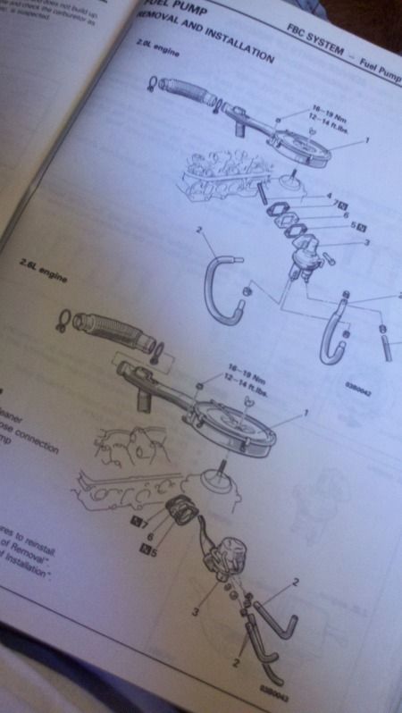

Only oddity is a plastic spacer on the fuel pump, but the instructions in new pump said if it has it to put it back, or the stroke could be too long and hurt pump.
I am out of ideas. I have worked this logically. There should be no obstructions from the cleaned out tank, to the inlet of a brand new fuel pump. No air leaks, etc. All this has been done with the gas cap off, so it is not putting the tank under vacuum.
Only parts that are not new is the sender, and pickup and float in tank. Pickup must be submerged or it wouldn't pull fuel with mighty vac.
My next step is to use the drain plug on the bottom of the tank, and run an inline electric pump and a regulator.
backtobasics
Anyone have a breakdown on the 3 ports on pump to make sure I am hooking it up correctly? I want to make sure before Igo back to Napa for another pump.

2.0 or 2.6?
droppedmitsu's avatar
droppedmitsu
slow50
your not missing the little rod that drives the pump are you?

Final answer:
The pump was not priming. It is very high on engine, and fuel was low in tank (only had a few gallons since I was dropping and raising tank so often.
We pulled fuel up with hand held vacuum tool, and quick attached to pump.
This little carb starts immediately!
