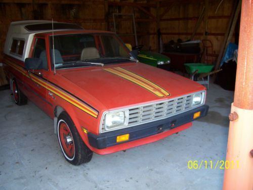

I just picked up a sweet 1980 Plymouth Arrow. It is all original, 85k miles, and in great shape...except for a cracked head.
I have looked for parts all over and I've found that the '79 and '80 trucks have a different head and the head gasket.
I would like to replace the head, but the '79-'80 head isn't available. Does anyone know what the differences are between this head and the '82-'88 head are? Can I use the stock intake and exhaust? Are there differences in the water inlets, etc...?
Any help would be great, I am struggling to find out what the story is. I would like to keep this truck all stock.
