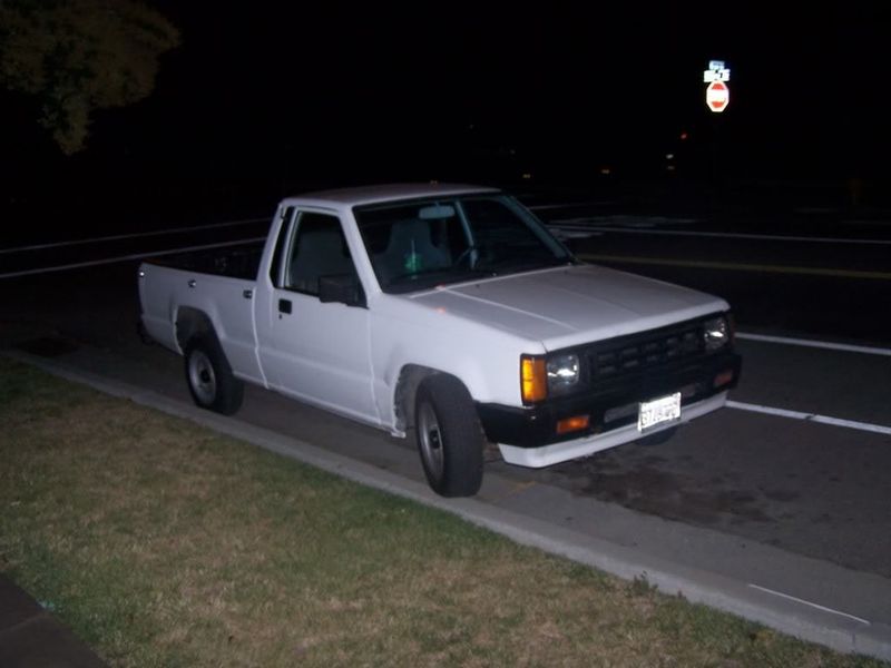

I have a 87 D50 carbed 2.0 4cyl/5 speed 2wd my goal is to make it into a mild wheeler rig and comftorable DD while retaining 20 mpg avg (in my dreams) and most importantly staying street legal/reliable and smoggable. I guess an expedition vehicle would be the best way to describe it. Heres some ideas i have. Im a little new to the mini truck scene so i'd like to hear some ideas. Heres a pic to get the creative juices flowing

slow50
nice lookin truck. why not get a 4x4?
