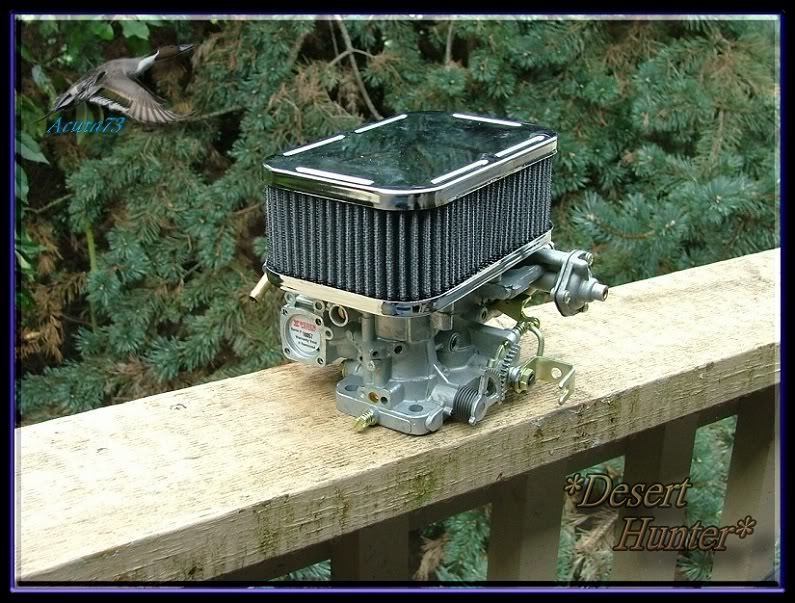

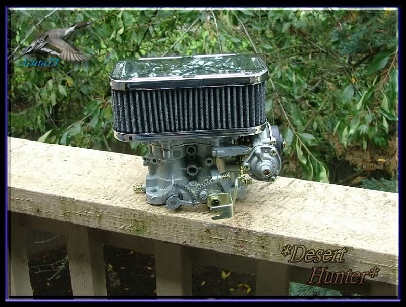

Well, about 5 years ago I had her up hunting Elk. We got some crazy weather. Days 1 and 2 were 70+ degrees, then it started snowing, by day 4 it was -2 and snowing HARD. We had to bug out a day early with a forecast of 4' in 24 hours. Dunno what happened, but the carb never was the same (water choke...hmmm...). Anyway, a couple weeks ago the old Mikuni started acting up again. Didn't feel like dealing with it myself (mid-80's Japanese carb/emissions...need a PHD in engineering to work on em), so I took it to a local. He said the choke-breaker was toast (no big surprise). I was fed up with rebuilding that carb (this would have been the 5th time) so I bought me a new toy:

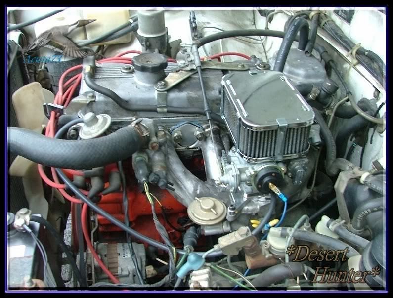

Weber 38 DGES (synchro)
Added a Carter P4070 fuel pump on a kill switch to keep it happy (no pictures, I just didn't think about it)

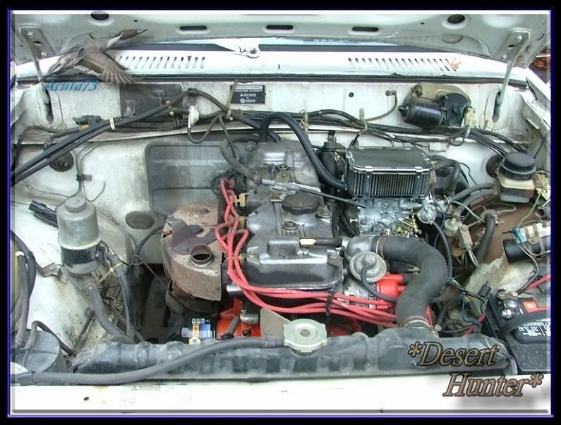

I don't have a "before" pic of the engine compartment, but I can tell you, it's one HELL of a lot emptier, now!!
You can see my DIY blanking plate for the old mechanical pump here:
She's currently in the shop for a final tuning and to fix a couple of "oops" of mine. I can set timing by ear 99% of the time, can't adjust a carb to save my life...

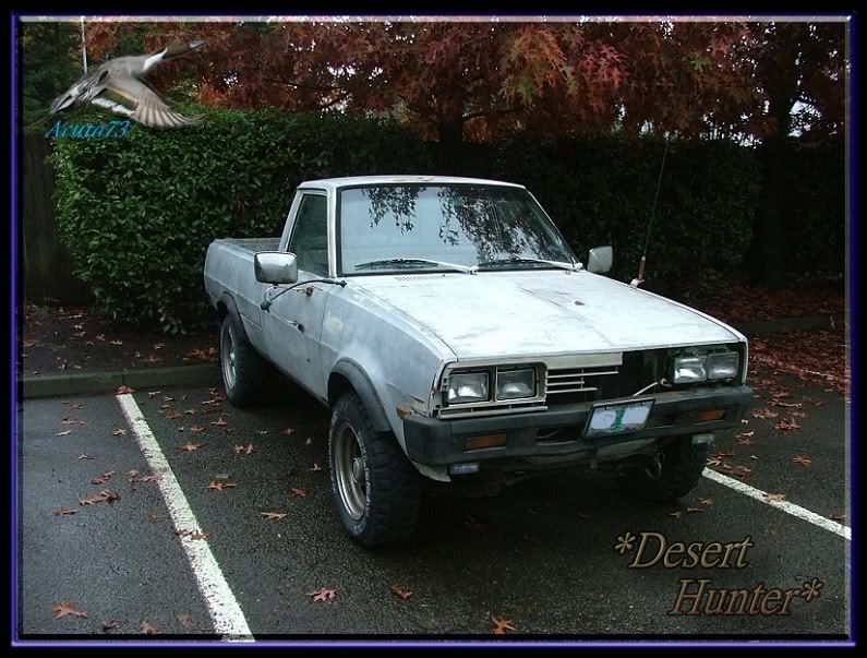

Well, what does this beast look like now?
Ugly...but with a damned good engine (and rebuilt tranny/transfer)!

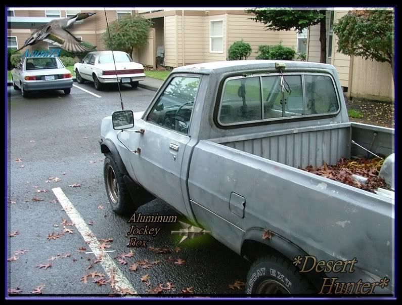

20. 2 Jockey Boxes to replace the 1/4 panels on the bed:
Passenger side box will house the deep cycle and inverter, the split rear window I grabbed off a MM in the junk yard years ago. Still need a lock for it...
