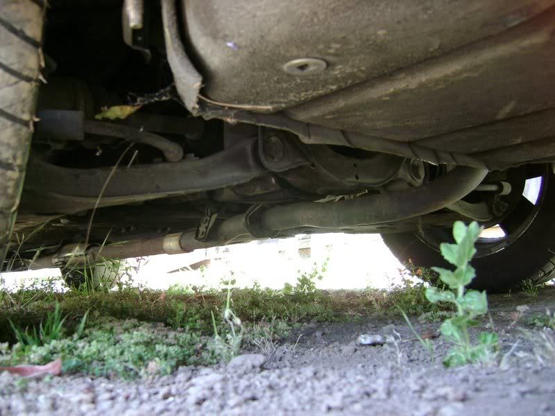

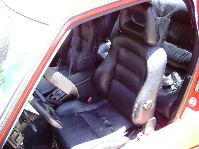

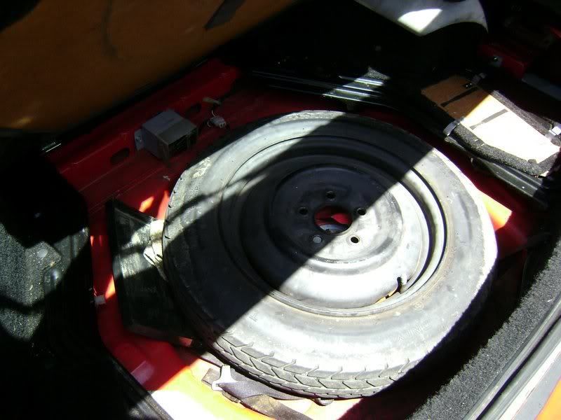

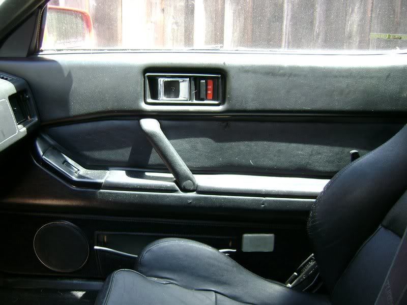

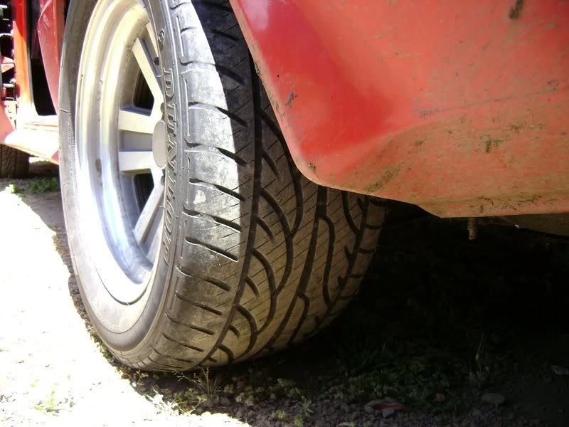

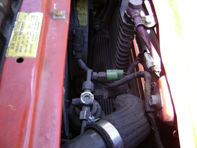

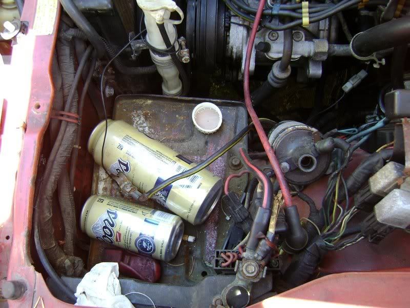

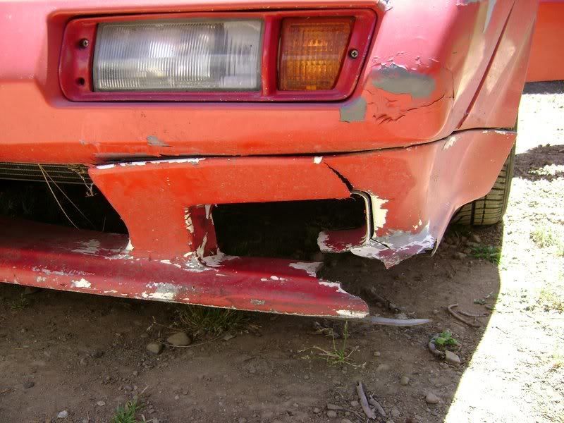

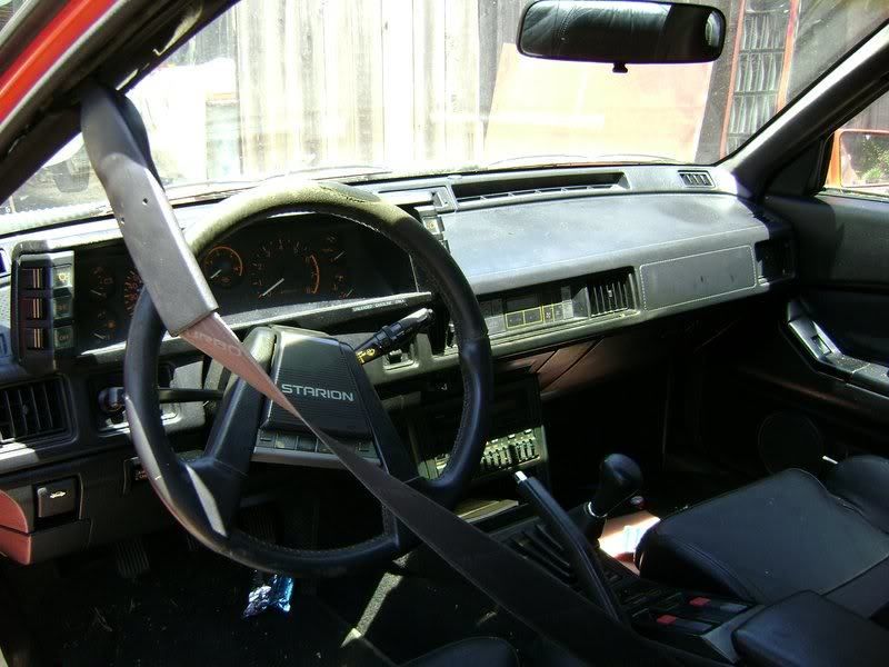

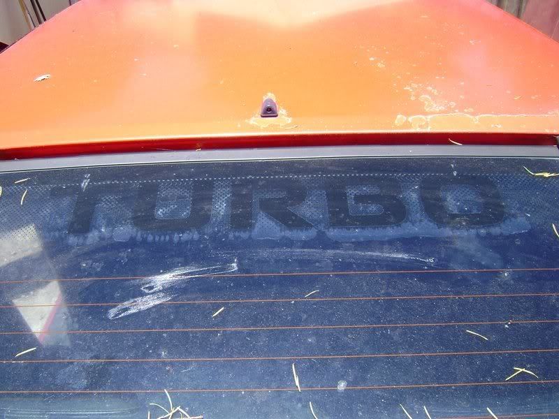

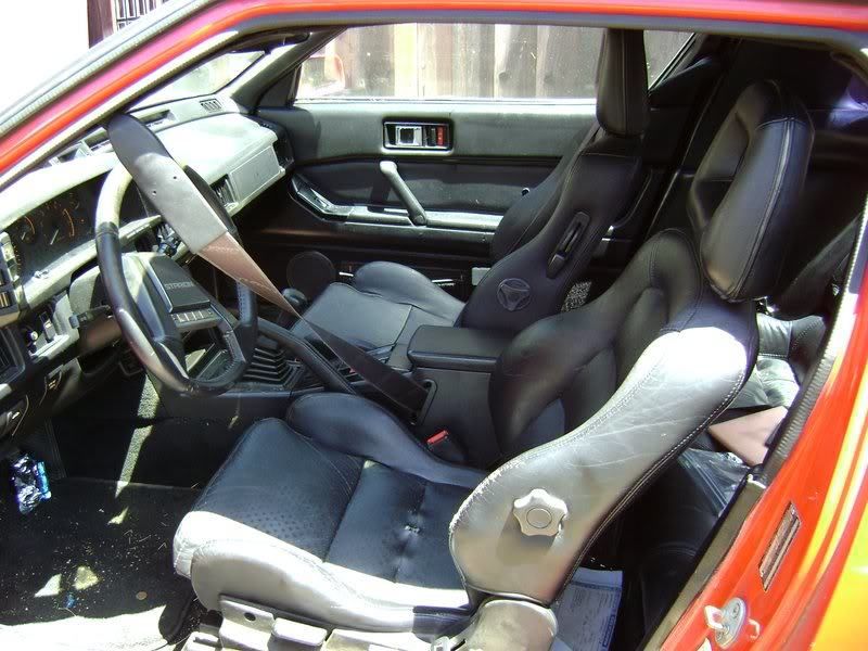

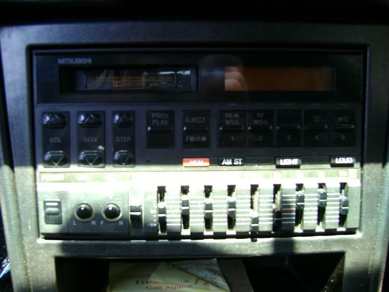

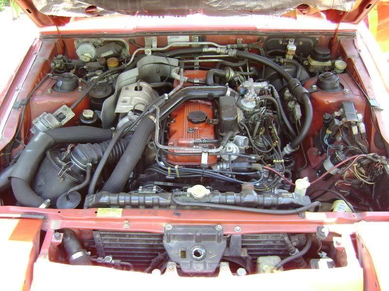

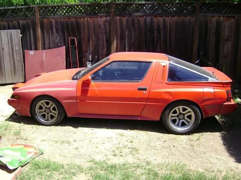

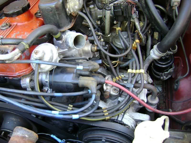

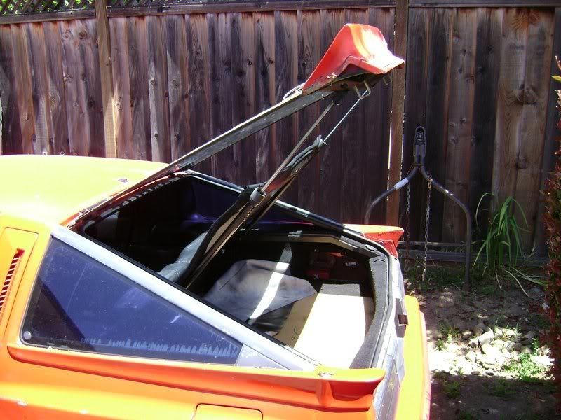

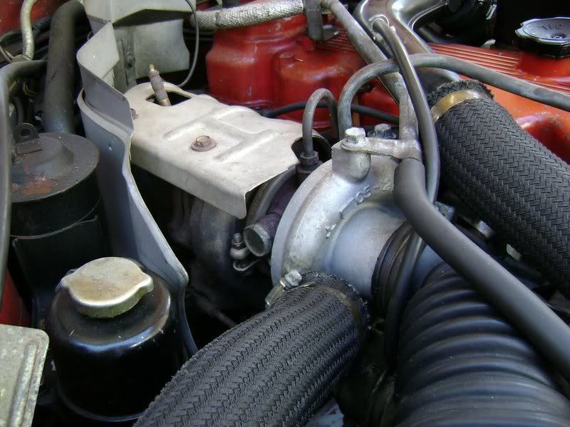

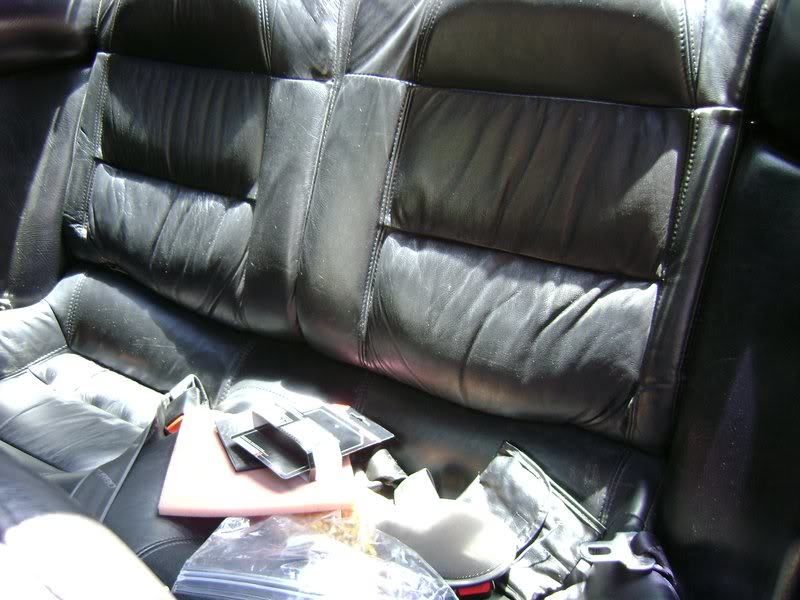

Pictures of the parts car.
the quote from my other car forum for the extraction:
The scope of the D50 project changed. I originally picked it up for free from a guy that said I could have it for free if I got it running. Drove it for about 200 miles and found it had blown a head gasket on every cylinder, cracked the head, and spun a bearing. While dead in the water on parts I began going crazy on fucking with its appearance because hey, free ratty minitruck. Everyone should have one little beater they don't really give a shit about at least once in their life, this was mine. Now just as I was finishing the rebuild of the original motor the Starion fell in my lap.

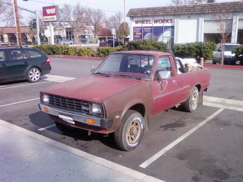

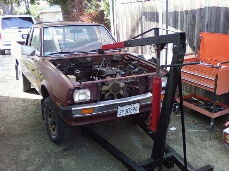

Here's pics of my D50, so named the Froot Truck.
Album with everything so far:
As it was driving:
Pulling the engine and tranny:
Fucking around with the dash, I painted it purple green colorshift paint and added stickers.
