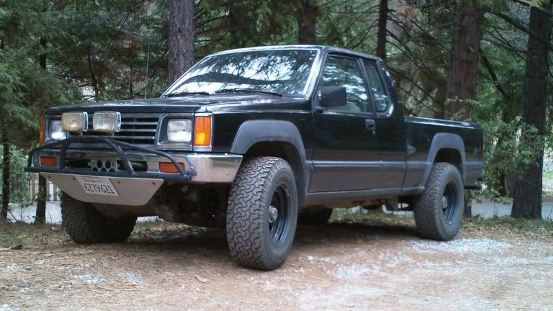

Im in Need of tires and would be nice to have nicer rims too. My Question is i have a 1989 D50 4X4 i was wondering if 31. 10.5. 15 would look and fit good. Has anyone here done it? im sure someone has. can they post pics please thanks you

Without a body lift, the 31's rub a little in the rear corner of the front wheel well...but no where else.
The picture above is with 8" wide rims with 4" backspacing. I have since changed to a 7" wide rim with similar rubbing results. I intend a 3" body lift in order to run 33" tires on 8" rims.
