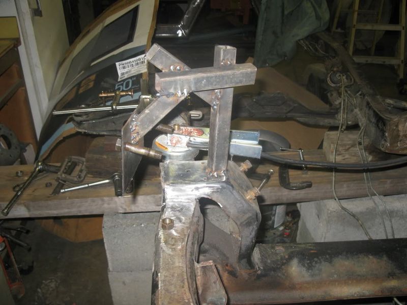

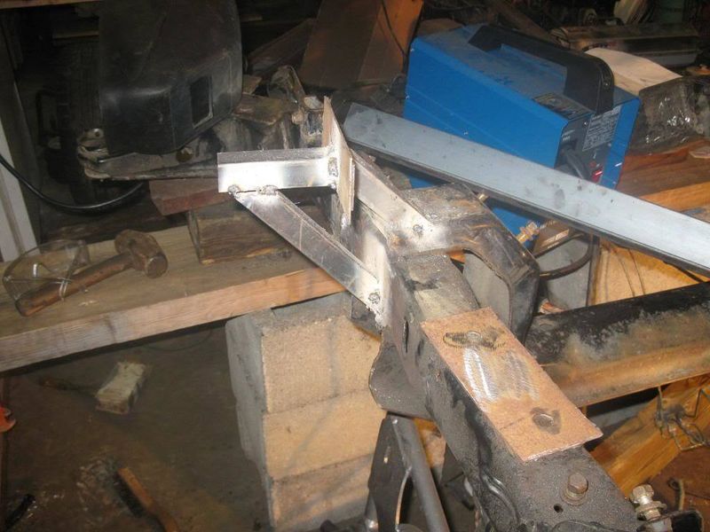

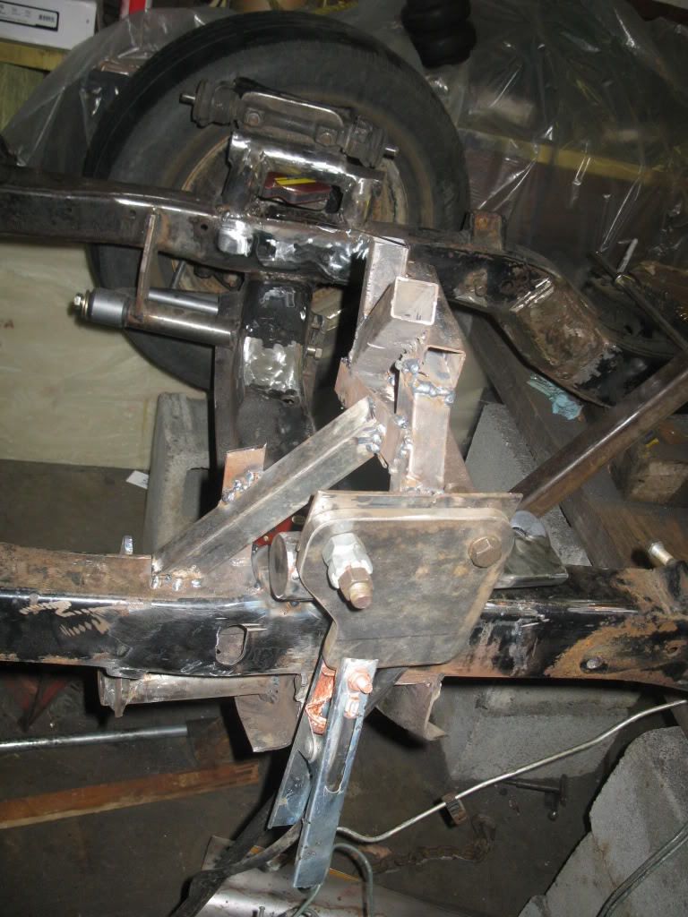

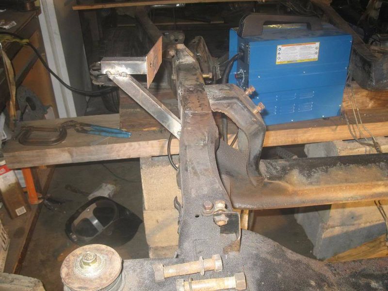

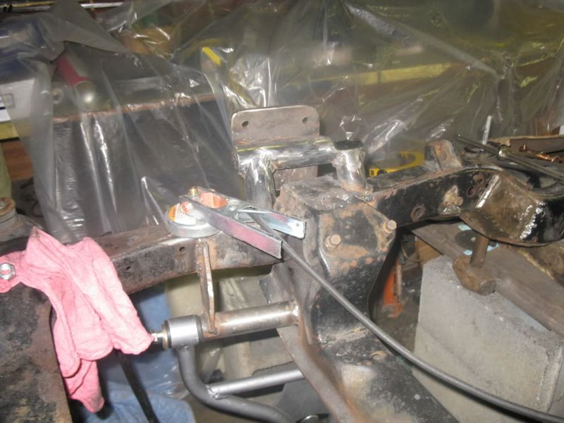

here is a pic of my uca mounts i made from scratch....with stuff i had laying around the garage. The plate that the control arm mounts to is getting cut shorter...
they are not done...still got to clean them up and a few other things.
Bag mounts will be added when i get my uppers and body drop done.
hope these help..

im not sure i quite understand whats going on with all that random 1x1?
baggedbmy93mazda's avatar
baggedbmy93mazda
ummm....ok do you weld much? make your own stuff....etc.....
that random tube is what i used to mark and keep my two original holes that the uca mounts to....i kept the factory positioning--it gave me a surface to build to/mock up etc.
