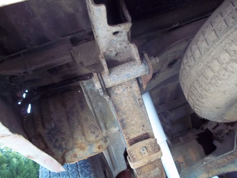

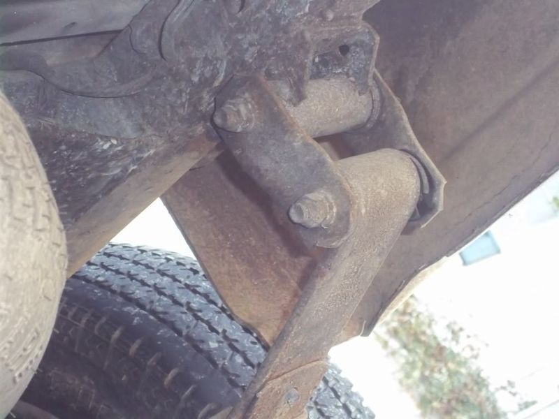

as you can see in the pics, it looks like my truck was hit in the drivers side rear and moved the leaf shackle any idea's on how to fix this???
drivers side
pass side
slow50
hard to tell by the angles of the pictures but it doesnt look like anything is bent. just looks like the bushings are shot.
droppedmitsu's avatar
droppedmitsu
Jack the truck up and support the axle. Then take off all the bolts on the shackle and pull the shackle off and see if you can get the leaf to drop to its normal position then put it back together.
old-skool_81
ok thanks ill try that
old-skool_81
thanks Josh, I got it fixed & new shocks installed and rides perfectly
