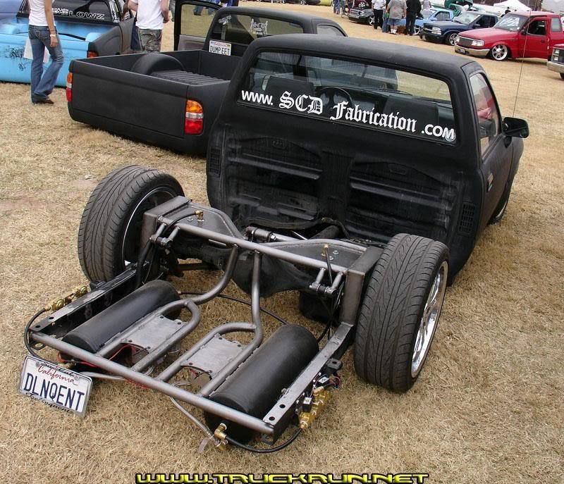

ok i have a 1990 mm i have my bag kit it comeswith everything to bag the front and back my question is my kit came with these baby notches u can weld or bolt on but my brackets have to be welded to the frame and the axle how do i ifi i choose to stick with those baby notches weld the rear brackets to the frame bc the setup is bags ovewr axle i need some help asap my truck is in pieces in my garage helllllpppppp

You need to build a bridge between the two notches to mount the upper bag plates. If the notches are too small it ain't gonna happen. There has to be enough room between the bag plates on the axle and the bridge for the bags to fit.

i would sudgest getting a bigger notch so you can lay frame. but if you dont want to do that you could get some tubing and build a bridge but raise it up and run it off the top of the frame rail instead of the insides of the frame rail. sorta like an arc if that makes sence.

Build a bridge like they said, something similar to this...
