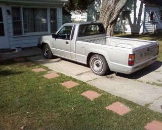

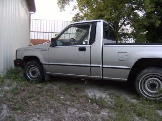

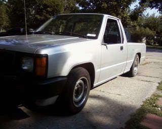

ok here are a few pics of the static drop... i cut 1 1/2 coils in front and in the back it has the middle leaf pulled and 4 inch block. I still have to replace rear shocks cause one is rusted thru...
this winter we will bag it with bag on lower bars, we will make the wishbone and all brackets will be burnt out at my friends house(has a plasma) the front will get aim spindles, DHRP control arms .. it will be tubbed for up to a 22 but will only run 18's unless she decides for it to NOT be a daily driver.. thanks to everyone who chimed in the last few weeks... this next week it goes to the state inspector and he will tell us out emmision problem and well finally make it legal.
before
after
