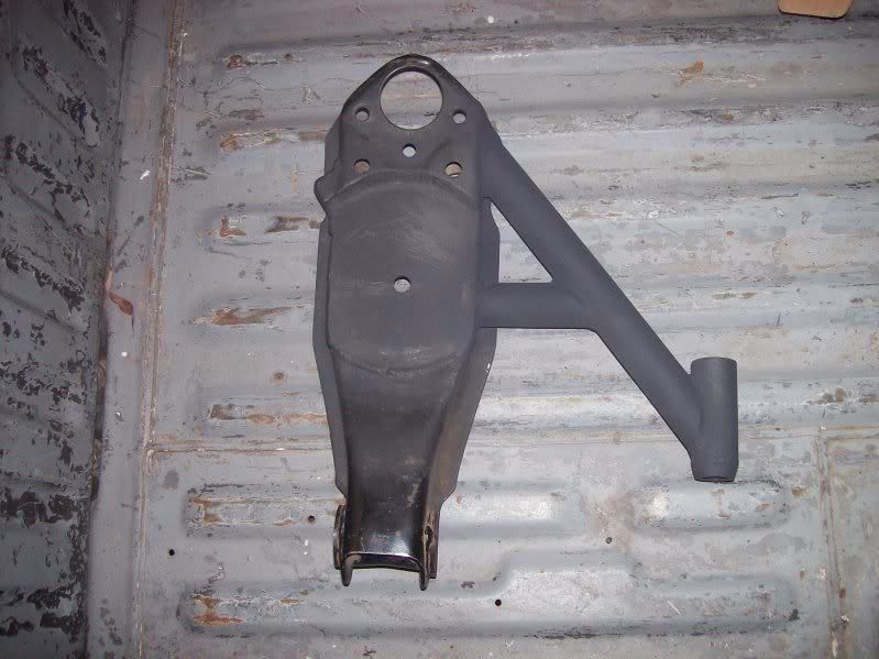

slow50
heres how not to do it. these are mine and i wasnt thinking about turning when i welded them up now it can barely turn so i got change the angle on the bar to get more turning out of it.

My goodness those won't work, but you know this now.
We had a kid at mightyd50 try to build his. When I first seen them, I really was being nice and tried to explain to him the problem. The more ignorant with me he got

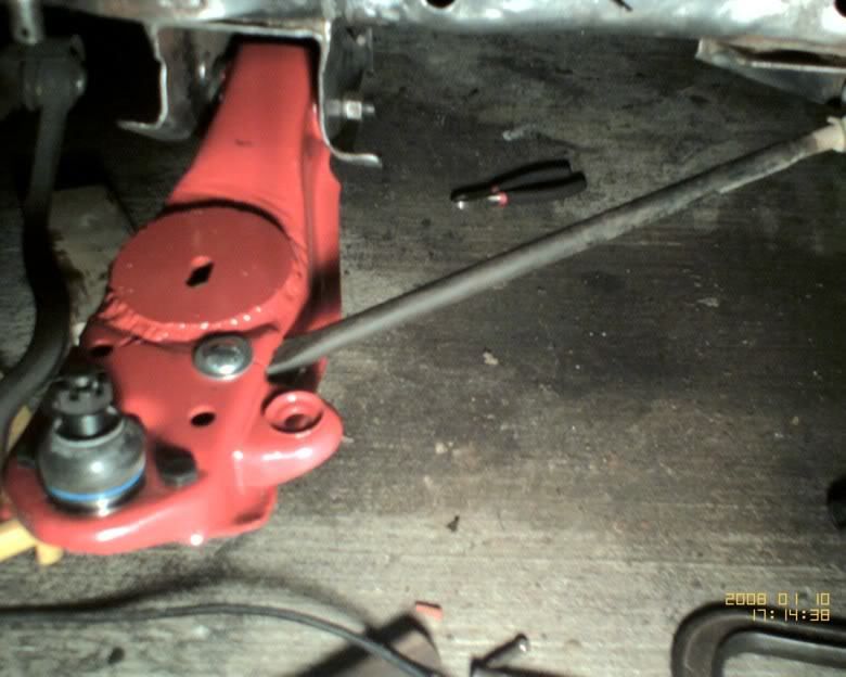

I just notched the side of my control arm and put the stock bar inside the arm using the same mounting holes. I have 18x9" wide wheels and can turn the wheel completely from side to side without rubbing at all. I would post a pic but I have already filled all my spots on here with other pics.

There ya go. That's how I did mine

did you put the sway bar back on or ditch it? im really thinking on going this route til i get some lowers.

I originally tried leaving the sway bar but it was binding keeping me from laying frame so I ditched it.
