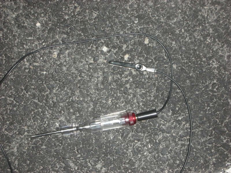

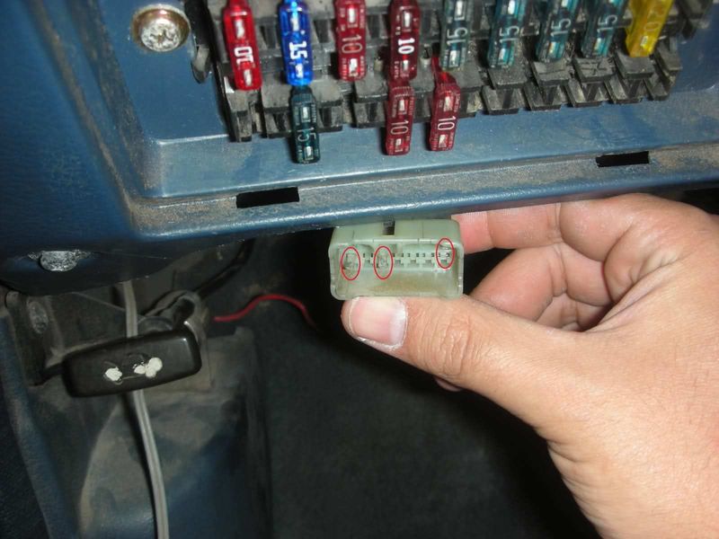

Like I stated in my first post I cant seem to get the LED probe test to work to check my engine code. Heres my probe.
And here is my engine diagnostic test terminal
Now I've tried everything to get something to light up but nothing ever does. I've taken the probe, grounded it to different points and used the probe end to see if anything light up. Nothing. Is there another connector Im just not seeing? Thanks.

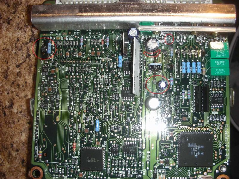

Update:
Took off ECU and was not pleased at what I found.
looks like a fried chip/circuit at D23 on the motherboard, some kind of residue near the cluster of capacitors and a singed black diode on one side at R112. There is also some kind of blue residue near D104

mi-mitsu
Well I'd definitely be looking for another ECU at this point. OR if you cant find one IIRC there is a place down in FL that will rebuild/test your exisiting unit after they replace all defective/leaky components. Cant recall the name or site, but it was mentioned extensively over at the 4x4wire forums for Mitsu's.
You might want to opt for option 2 as anything you get from a yard will have been sitting for awhile exposed to elements, and anything on ebay is just as old as what you have now.
IIRC I think the rebuild cost was $150 or so depending on unit plus return freight costs running anywhere from $10 USPS to $50 overnight if you're desperate.
If you have the time and $, I'd send it out for evaluation and repair while you're digging into other components and doing other testing.

The link i posted doesnt use a led probe, it uses a mini 12v buzzer which is way easier then using a led light or multimeter, actually read it before just disregarding it.
