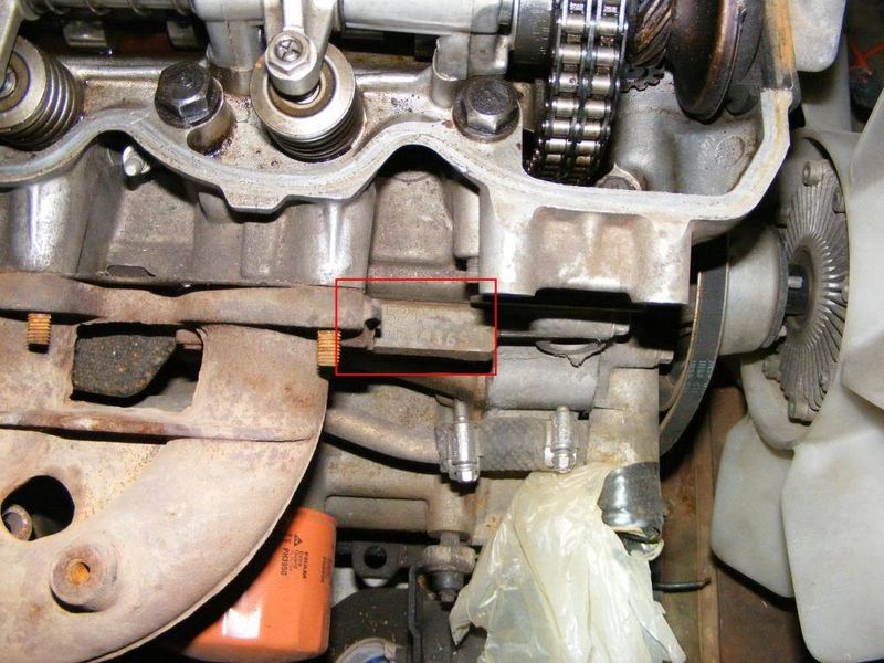

cyrus's avatar
cyrus
I'll post a picture of mine, I don't get home for about another 1 1\2 hours though.

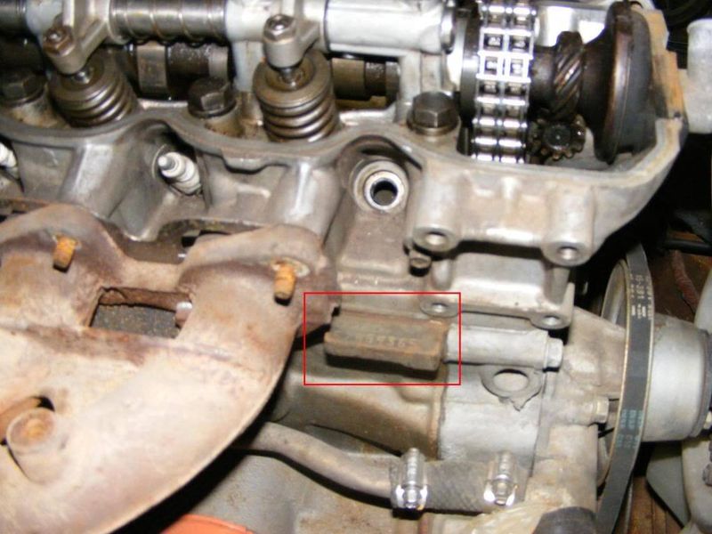

droppedmitsu's avatar
droppedmitsu
engine code will be about the front middle section of the passenger side of the BLOCK on a flat planed surface a little below the level of the waterpump. Will be g63b if 2.0 or g54b if 2.6
cyrus's avatar
cyrus
This is how mine is. My motor is older than yours and is a G52B which is a 2.0.
