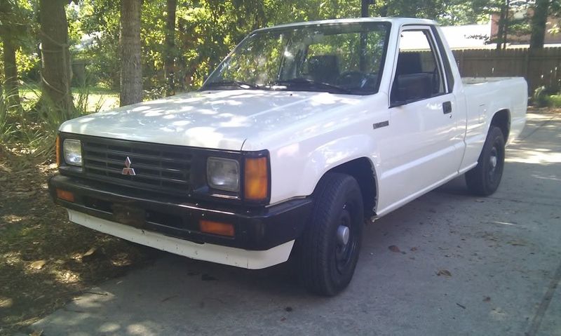

just picked this up yesterday, almost perfect condition!!! 104,xxx original miles 2.0 5 speed and im wanting to make plans for it just not sure what yet, let me know what you think, gonna drop it soom idk how low tho and if i just drop it with the tortion bars will it mess anything up?
as you can see super clean

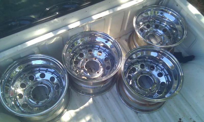

picked these up, im not sure if they will be to wide yet

your truck doesnt have torsions in the front it has coil springs. looks pretty clean though.
droppedmitsu's avatar
droppedmitsu
You weren't kidding, that is SUPER clean. Yea, only 4wd versions of these trucks have torsions, we have coils. You either need to cut them or buy some drop coils or spindles. And get an alignment afterward
