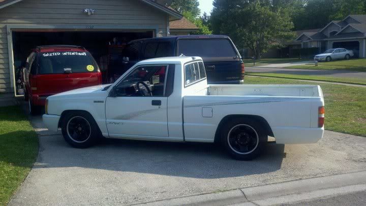

this is how shes gonna look until it gets cut up to get bagged. which shouldnt be terribly long from now.
threw some 2011 Tacoma steelies on it that i got from work. and its lowered about 3/5

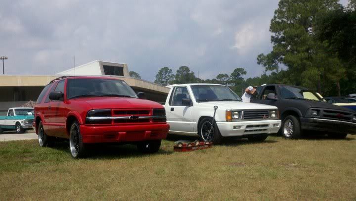

my mitsu sitting next to my daily driven Blazer.. and my bodied Radio Flyer lol

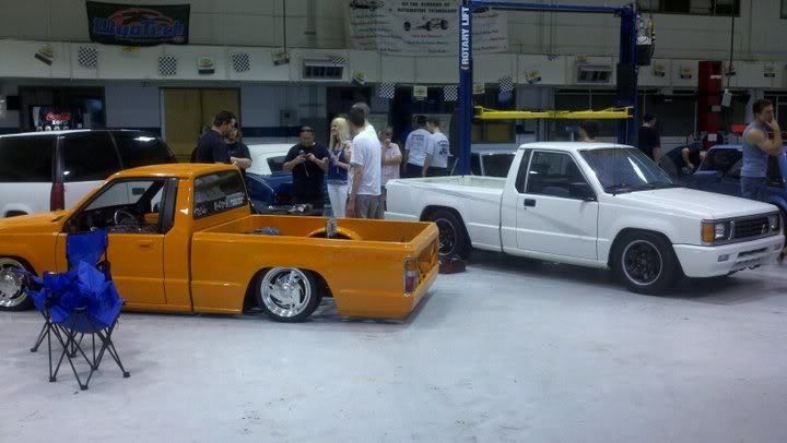

and sitting next to my friends D50

Looking good, those Tacoma steelies look damn good, if I wasnt about to put my rims on I would throw some of those on my truck
mclovin
thank you. i snagged them from work for $21 lol. They were takeoffs. I was going to buy some billet Centerlines from a friend of mine but i figured my money was better spent elsewhere for now. im hoping these taco wheels will tuck in the rear lol
m0ta
Looks good man how did u lower ur mitsu? Im tryin for the same stance
mclovin
not gonna lie. i wouldnt have lowered it this way if i didnt plan on ripping it all out soon. but for the front i just cut like 1 1/2 or 2 coils out of it and cut the bump stops out. you will need an alignment badly after this. it throws your toe out of whack hardcore. and the back i have the middle leaf pulled and a 3 inch block
