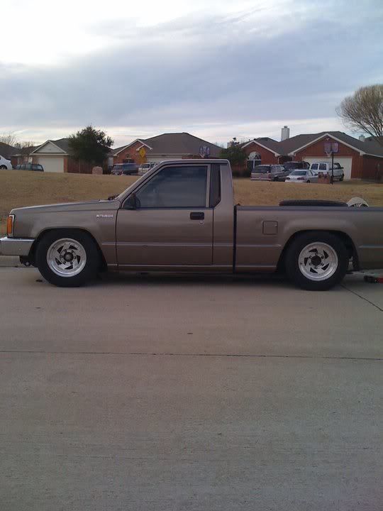

well here it is.
cut it short here.
plan was to put a 1jzgte twin turbo motor in.
freind convinced me to throw in a 5.3 vortec v8.
ive allways wanted to put that engine insomething ever since ive seen some awesome vids on youtube.

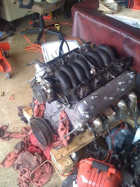

anyways scored myself a pretty clean 5.3 vortec out of a 02 tahoe.
came with a few things. but it super clean. had the better version of the coil packs. recently for christmas i bought a ls1 intake mani and injectors for pretty cheap.
now im just sorceing parts like the accessories and t56, need the harness and ecu.

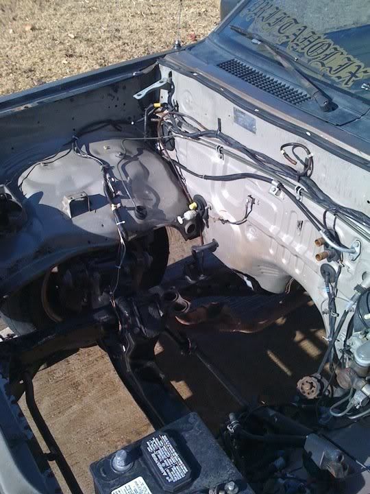

anyways the truck is an 89 got a killer deal on it for 300$ halfway running. after spending some money on it found out the engine was bad. sold the parts i bought for it to run, sold the motor. cleaned up the engine bay.

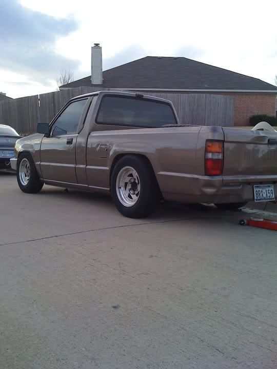

my suspention is going to be just tempo. as it sits it has 5 inch drop block on the rear. and cut the front springs way to much. 3 oils insted of 2 because i want it LOW...
plans for rear back half 4link with coilovers. front will have to be upgraded to 240sx crossmember, ps, moddified super angle steering knuckles. 5 lug front, ford explorer 8.8 rear end. wheels ive been wanting to do the mustang rep wheels 17x10 front 18x10 rear.
anyways pics.
the current wheels came on the truck with those size tires. just money issues with trying to get my daily driver running comes first.
but as it sits with the motor would be that way for a while till enough money the other mods ive been wanting.
enjoy fellas
