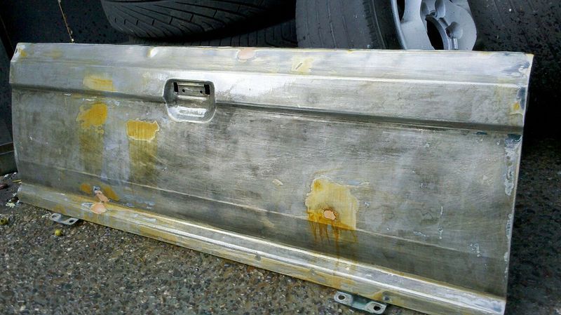

Aircraft Remover + Sanding

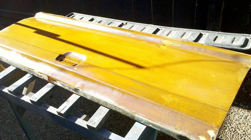

Hydrogen Peroxide + Vinegar + Salt mixture sprayed on and brushed with a sponge

After 10min
324284_10150513181172384_676302383_8737971_626210102_o by aorolfo, on Flickr
After another 10min

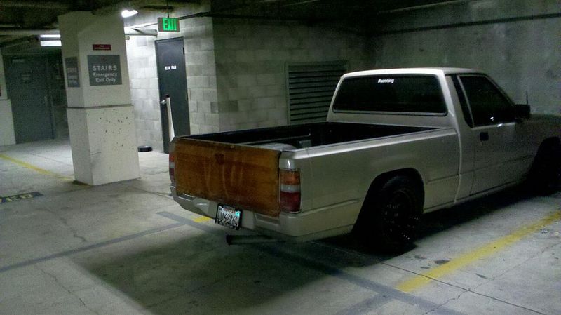

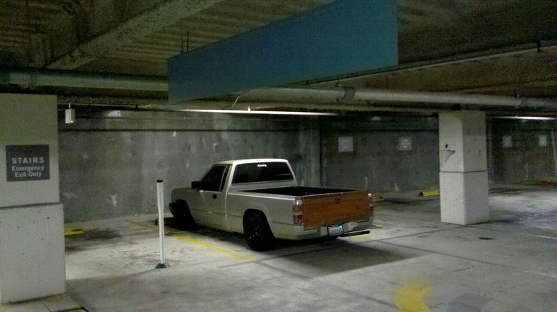

Finished Product
336678_10150513647347384_676302383_8740527_72868278_o by aorolfo, on Flickr
322505_10150513745742384_676302383_8740892_982425762_o by aorolfo, on Flickr

like the rusted hood import thing?
aorolfo
yeah wanted to see how it looked,, i personally like it
sabralvah
That looks awesome. Just the bare metal would have been pretty cool too, but that would have rusted through in a month; at least where I live.
aorolfo
mine rusted within hrs with this solution i read up on,, Hydrogen Peroxide + Vinegar + Salt,, the sanding was the longest process for sure
