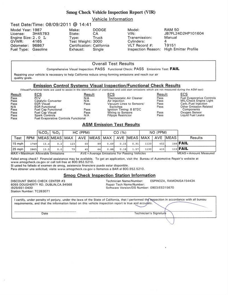

Update 8/9/11 Failed. Results attached to bottom of thread.
My '87 Ram 50 2.0 5spd has always given me issues when it comes to passing smog. Over the years I've changed the carb, cat, thermostat, and o2 sensor to get it to pass.
Last time it failed NOX really bad and I got a 2 year waiver.
I cleaned and tested the EGR valve, ran a bottle of redline cleaner, changed the oil and replaced the air filter. I drove it a lot for a week and got it pretty hot before the test. I attached the results.
The tech says to change the plugs, run 91 octane with a full tank before re-test, try a bottle of CRC guanranteed to pass, bring it in really hot leaving it idle and have them run it again.
It's running rich. Anyone now how to adjust these Mikuni Carbs? What else should I do? Would testing it without the air filter in help? I could retard the timing a couple degrees too.

psychbiker
I ran a bottle of CRC Guaranteed to Pass, changed my plugs, changed the thermostat, removed the air filter, inspected the vacuum lines, ratarded the timing 2 degrees, ran 91 octane through it, max filled the tires, drove it 30 miles, left it idle and had it re-tested.
It Failed
They did a Manual Mode first and the numbers were kinda hoping all over the place during the 90 sec 15mph test. The last 10 seconds the numbers dipped to passing levels.
So we tested it for real and it didnt pass. They waited and tried it again and no luck.
My numbers are attached. I failed on CO but passed on HC, and NOX. The mechanic thinks there may be a misfire. I'm pretty sure I gaped the plugs correctly.
I cannot find a schematic/diagram for the Mikuni carb. I'm going to call/email Mikuni.
