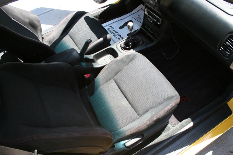

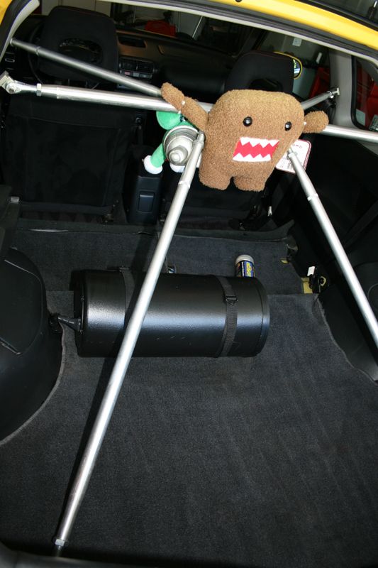

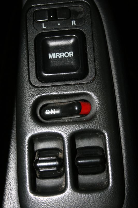

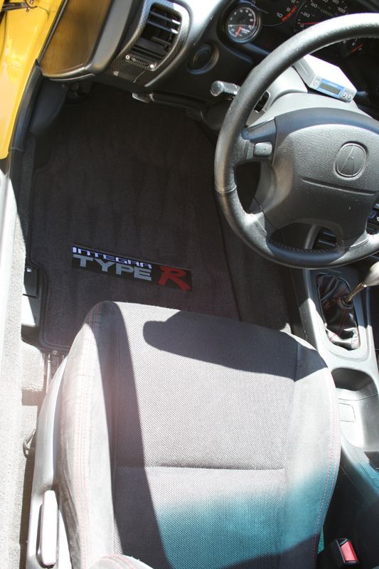

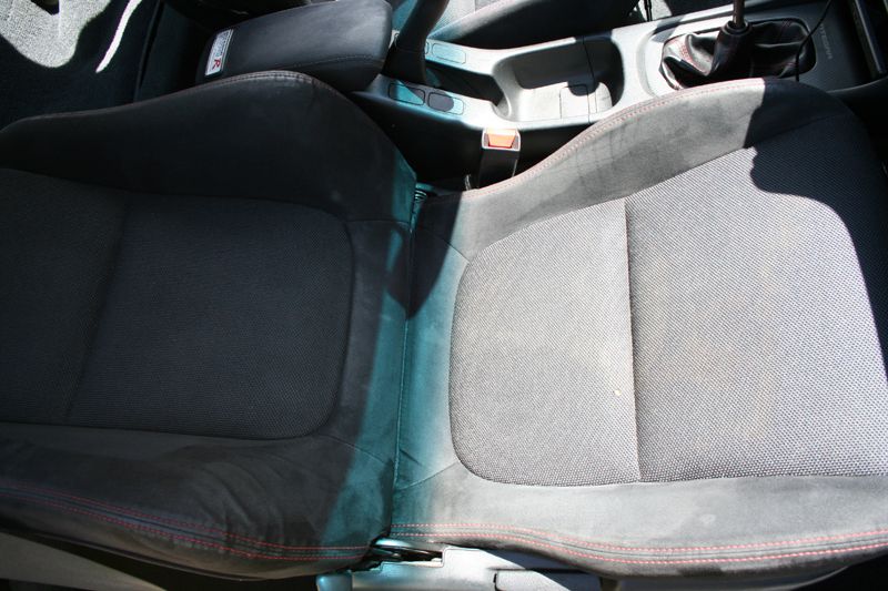

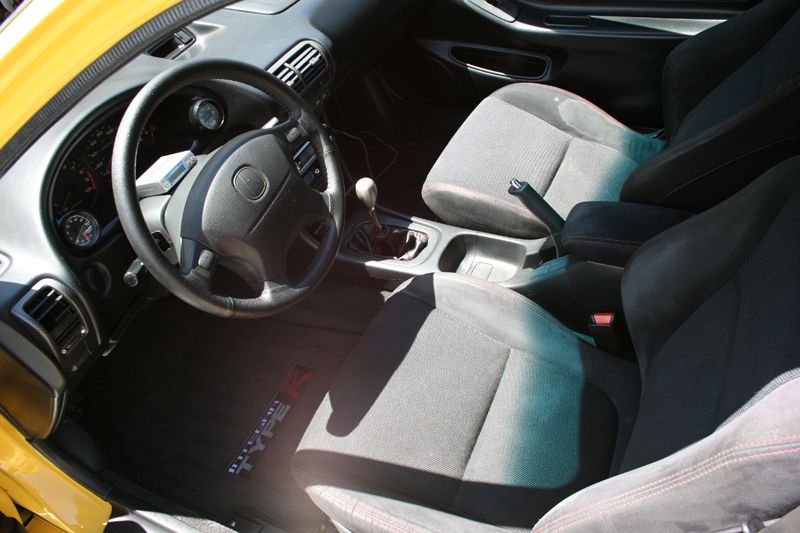

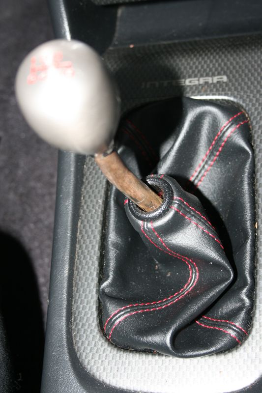

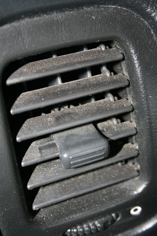

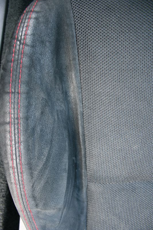

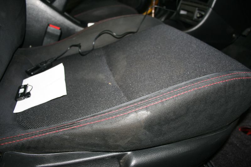

Here are the pics: We will start with the Interior...

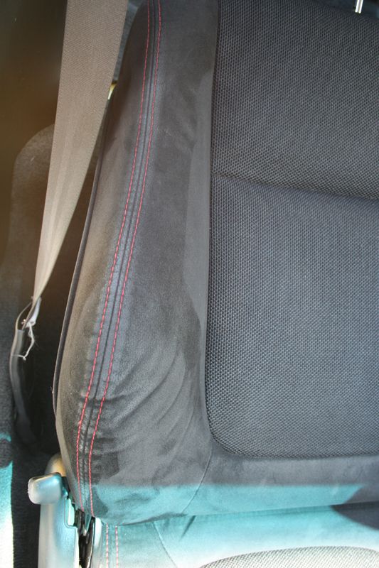

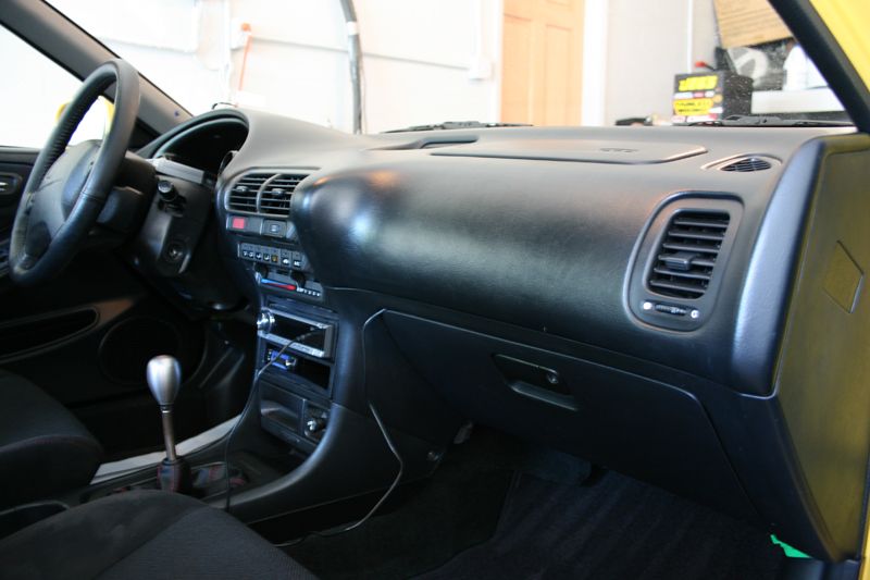

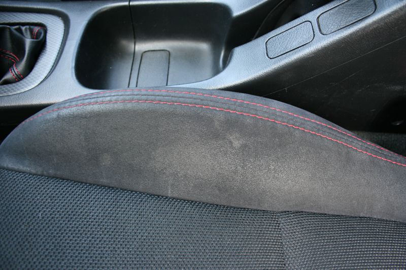

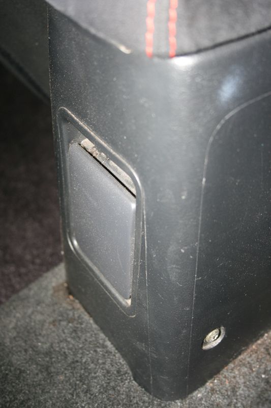

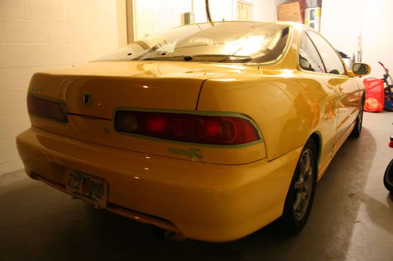

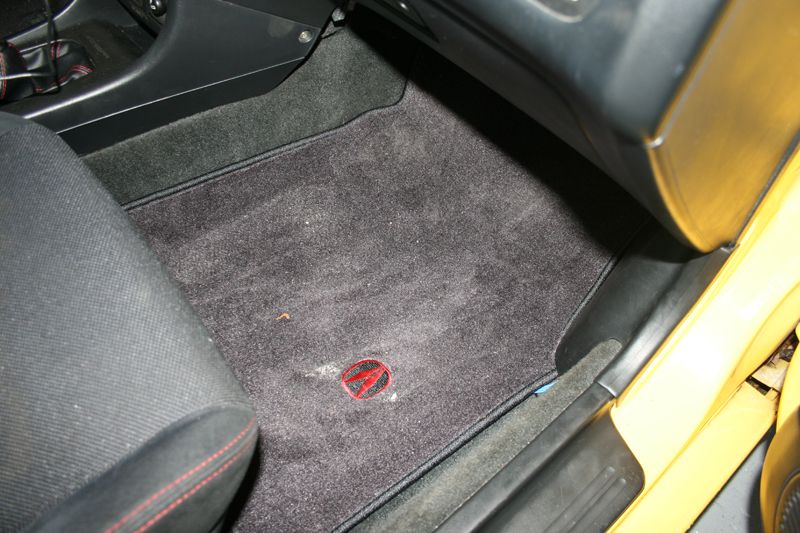

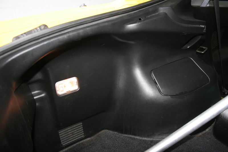

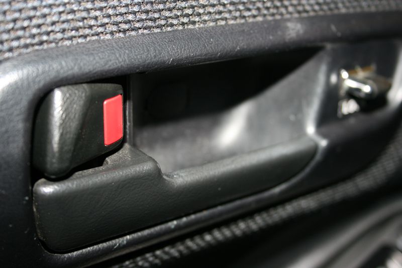

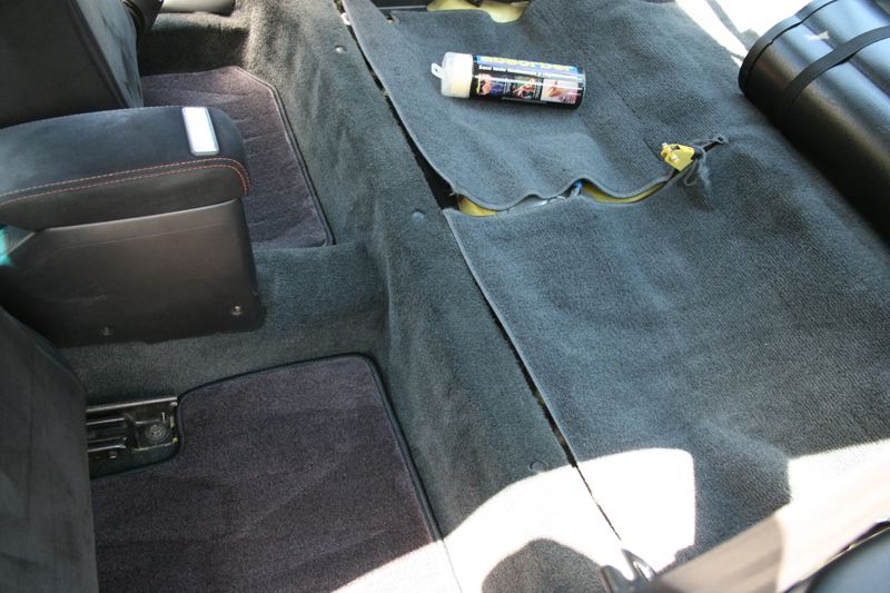

BEFORE PICTURES

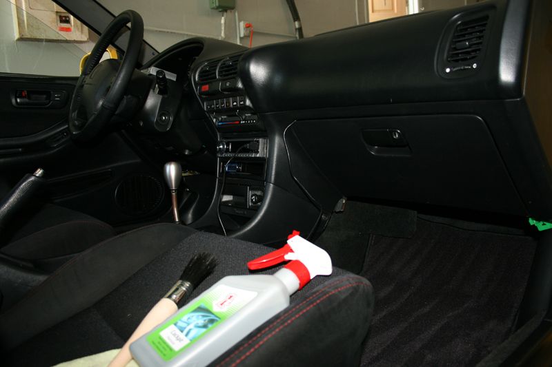

INTERIOR AFTER PICTURES

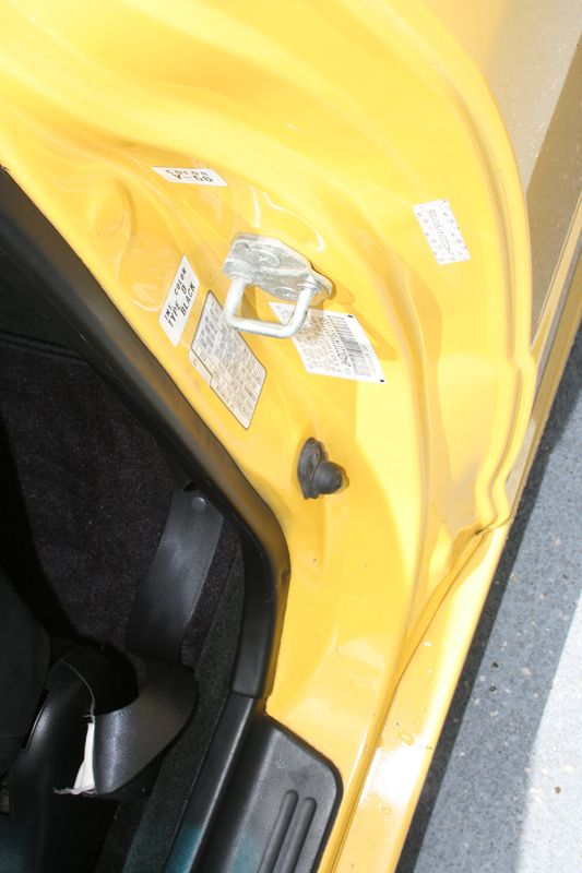

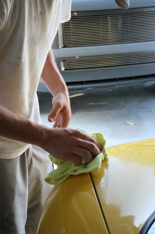

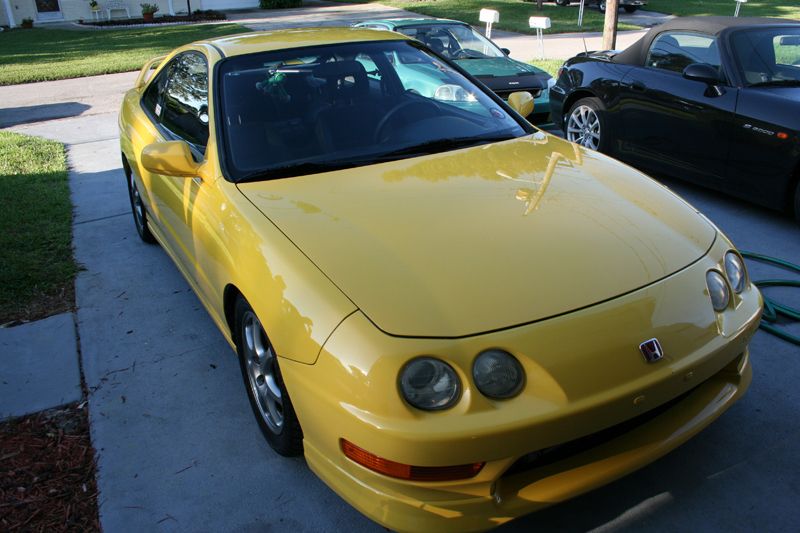

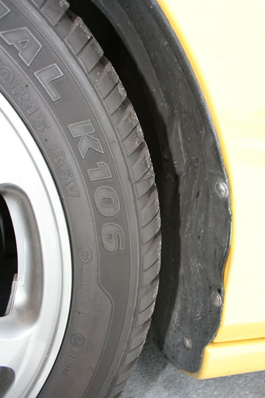

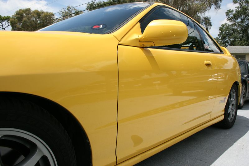

NOW TO THE FUN PART! EXTERIOR! Unfortunately, I took all before pictures of the door jambs and forgot to get after shots, but everything I took a picture of was either removed or cleaned ;)

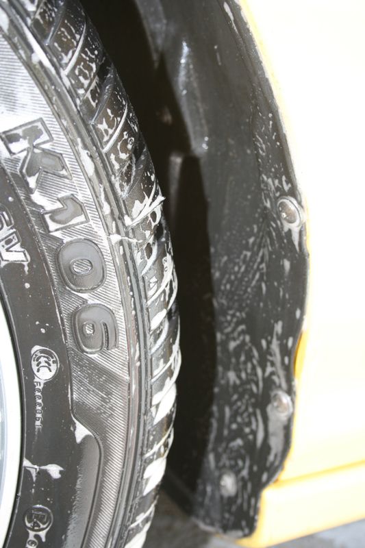

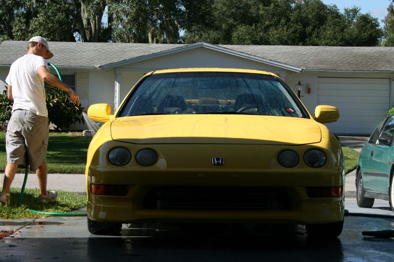

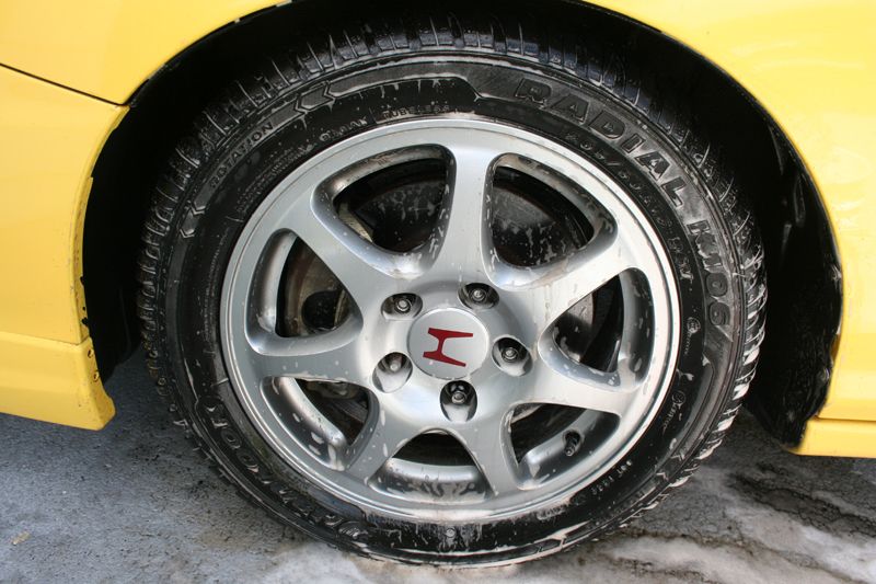

Washing the wheels and door jambs..
Claying the car..

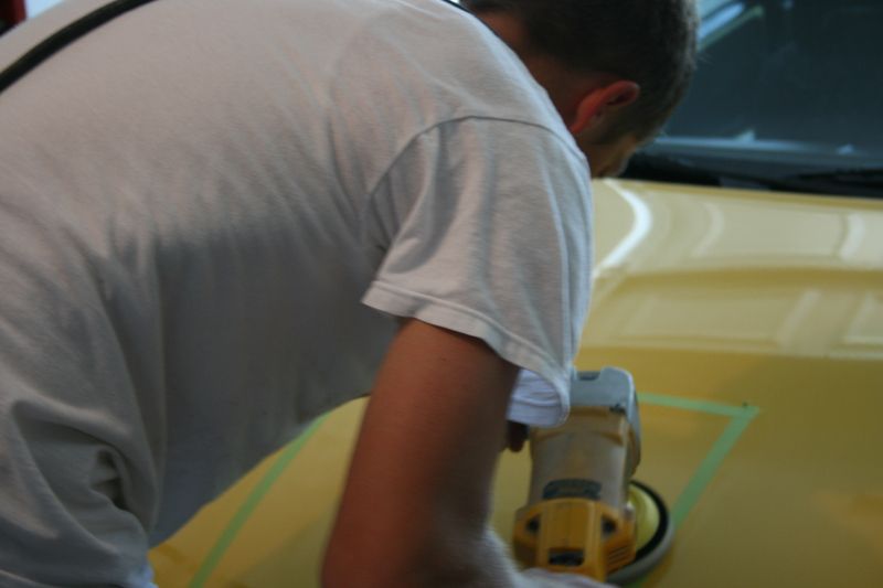

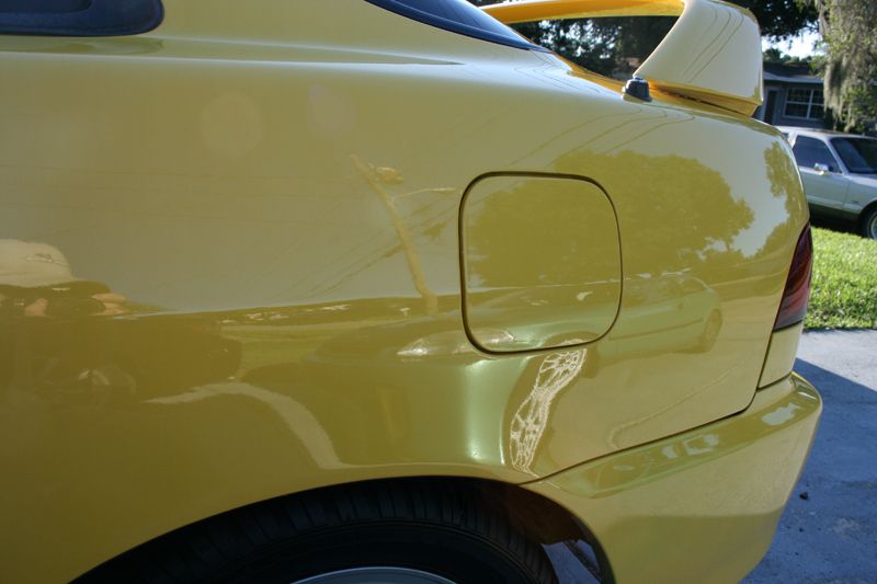

Test Spot on the hood...
50/50 on hood with Menzerna IP/LC PFW Pad

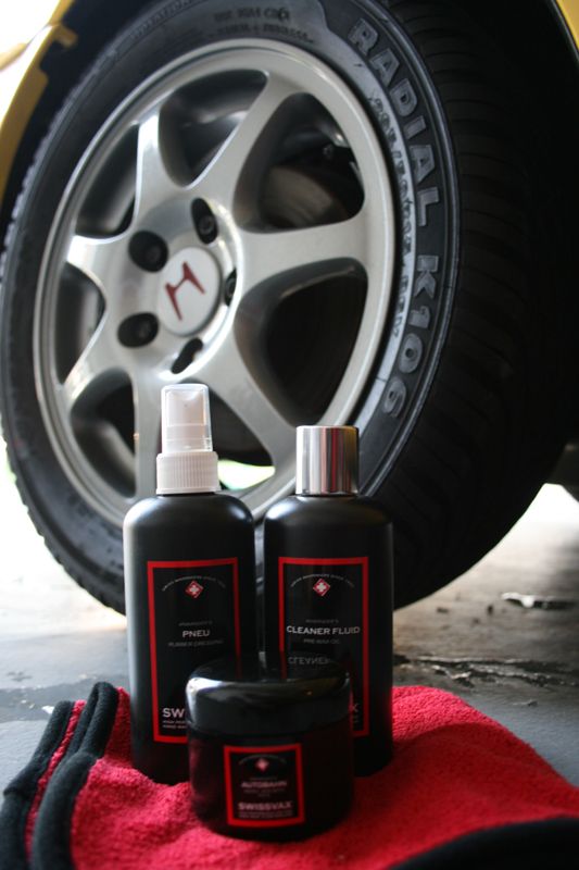

The wheels get the best treatment possible, I swear that wheel wasnt floating when I took the picture! :lol:

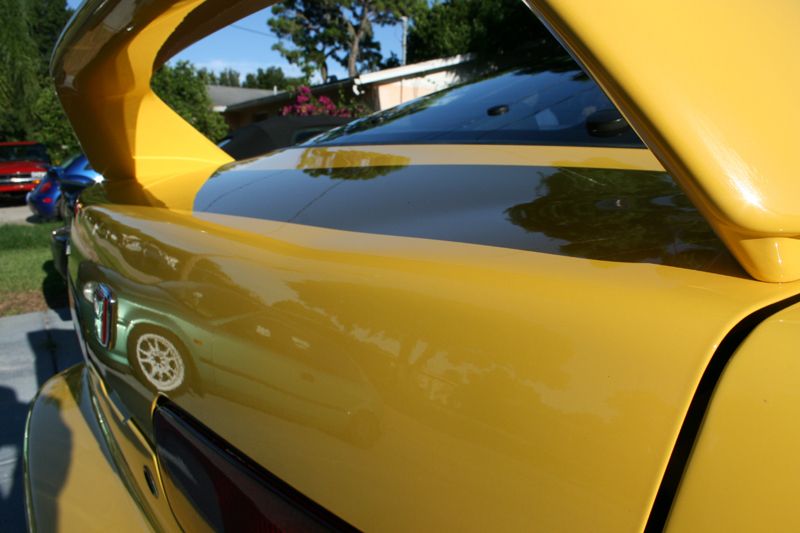

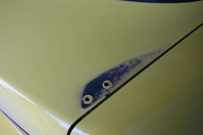

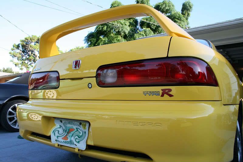

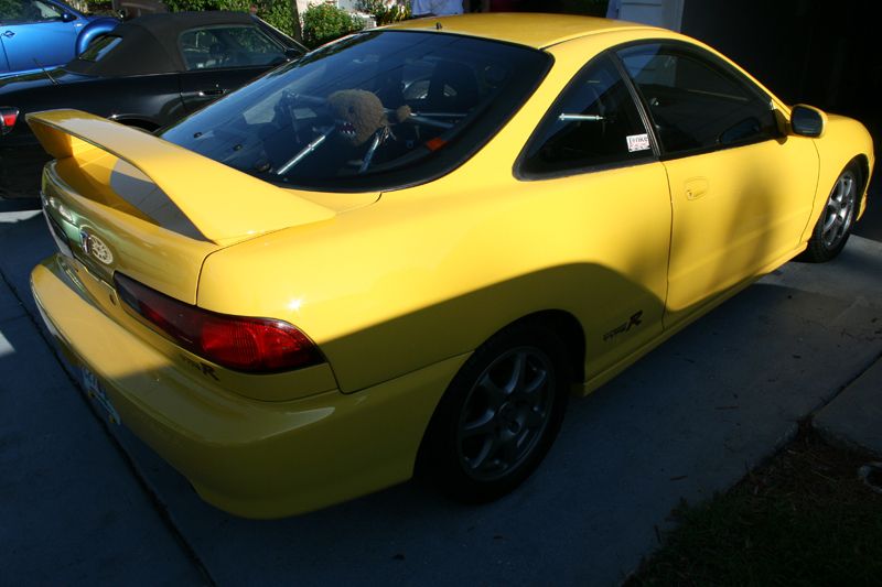

Taking the wing off, this enables me to polish the trunk lid the correct way.

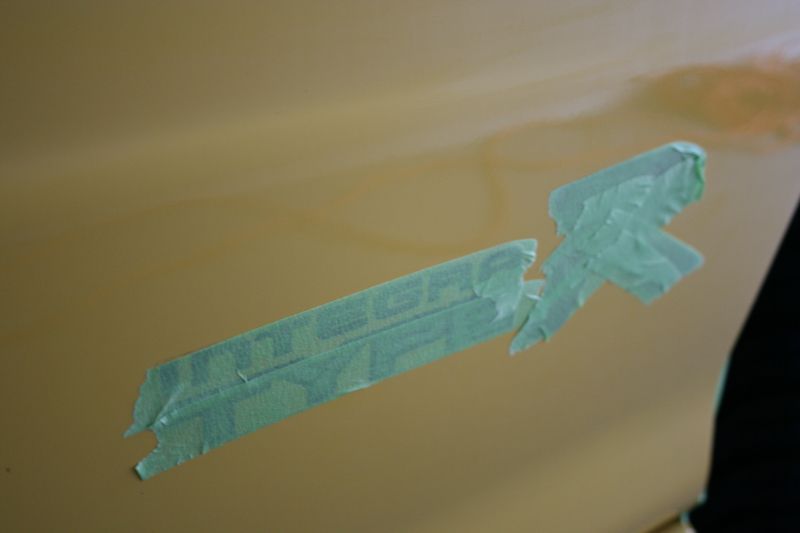

Taping off the car...
Did I mention this was a Jap car?? :lol:
It aint a tight car unless its Type R!

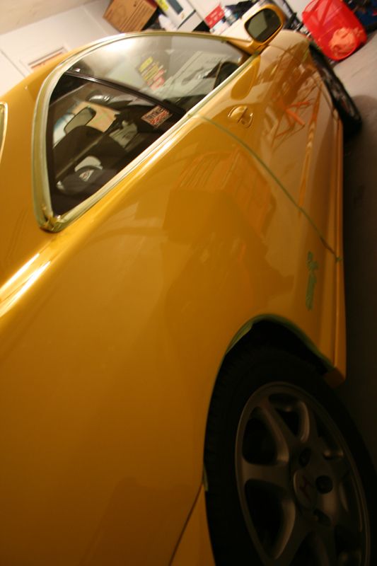

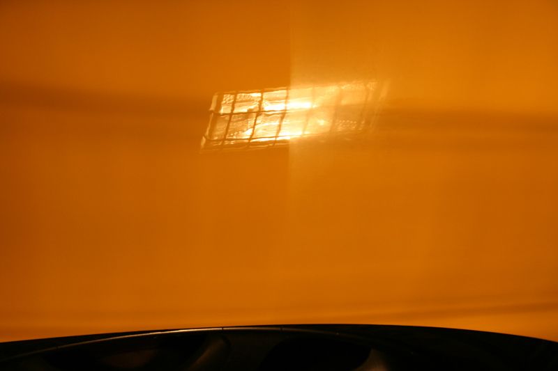

50/50 on Front Fender after IP/PFW

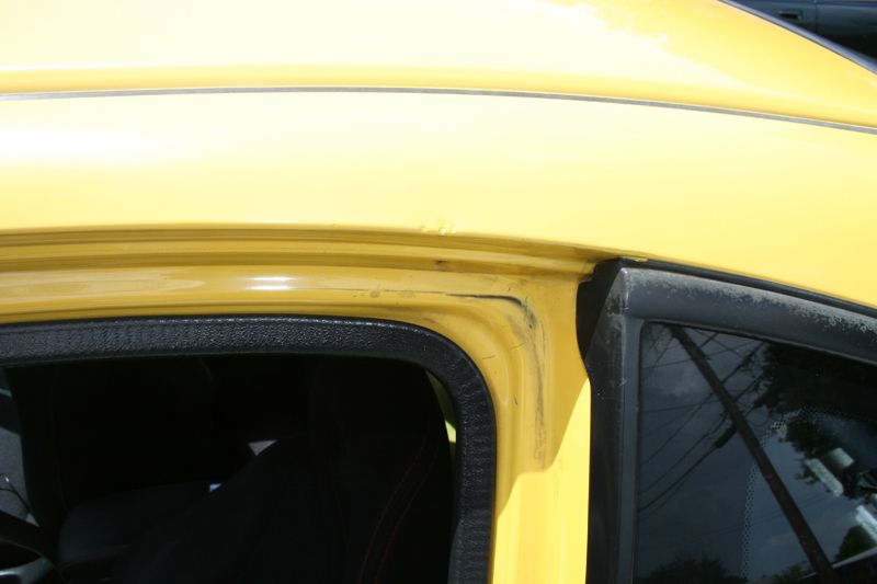

Did I mention this car needed to be polished??

Last shots for day 1...Still need to go over again with 106ff/white and put LSP on.
After the wing bottom was polished, we re-installed to do the top. The tape is so that I dont hit the already polished fenders while polishing the wing...
Final Rinse Down..
FINALLY FINISHED!!! This is when everything pays off! :nerd:

I like how the interior became so neat. great work
