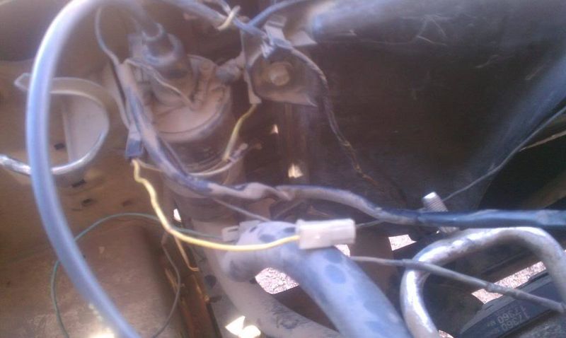

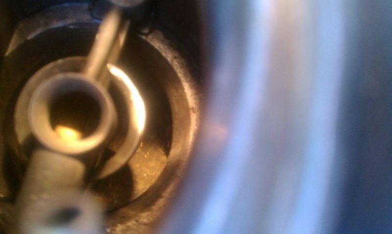

Thank you very much for the responses. I checked fuel flow out of the pump and it seems fine. Timing and plugs seem ok too. I also ran it with the three exhaust pipes that go into the intake disconnected and it didn't make any difference. I did find a wire disconnected, its a yellow wire coming out of the coil. Anybody know where this is supposed to go and if it will cause problems? I still think the secondary isn't opening because the throttle plate on the first barrel is clean and shiny and the second one is dirty like it hasn't had gas on it in a while.

I believe the yellow wire on the coil is the tachometer lead.
After seeing the pic of the throttle plate, I believe you're right about it not opening.

That was my first thought too but it has a factory tach and it works fine. Thank you again for all the help, I need to get it running properly to pass emissions then I'll get a weber
