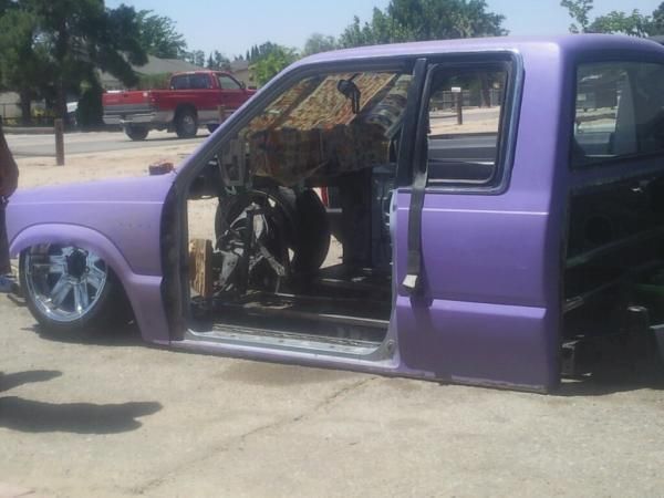

this is a project on my mazda i just joined so its a bit into it already heres some pics
that back half is from the first re build its getting cut off and redone from cab back

nice... lovin that bodydrop.lays hard
