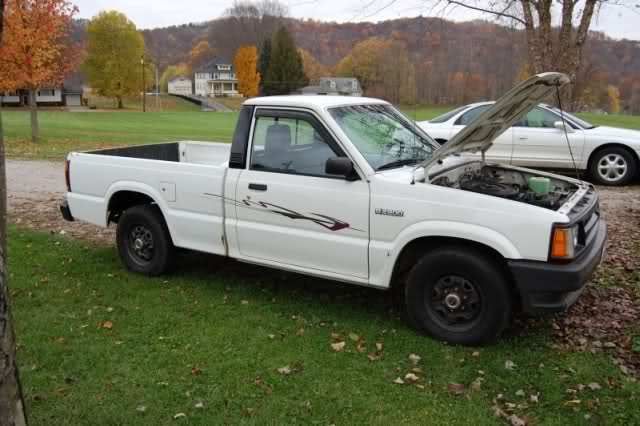

Heres the old girl a few days after I got her all skyjacked with the old school graphics.
Removed the graphics and took off the center caps.

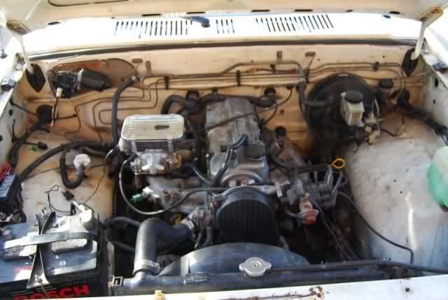

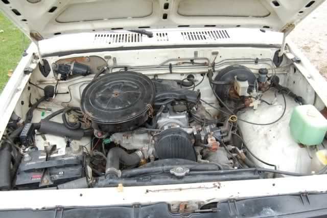

Decided to quit messing around with all of the mess and follow the advice of the rest of you and get a weber. It was only a hour or so to install. Started right up zero problems.

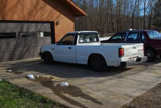

Finally slammed my dawg. Well slammed as far as I could with the drive way I have to go up each day. Reindexed torsion bars, removed bump stop brackets, mono leaf + helper w/ 3 inch block. Isuzu pup shocks.

looks sweet. now i know what mine will look like lowered haha. does it bottom out much?
xjoewhitex's avatar
xjoewhitex
Not really besides the pot holes you don't catch in time. This thing rides about like it did stock for the most part.

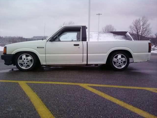

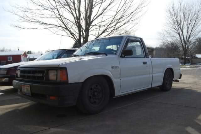

Heres the newest picture took this yesterday.. I raised the front up about 1/2 inch today, it was raked too much and my tires were rubbing my fenders still.Also you might be able to see my new side exit.. right before the tire.

looks good man..
