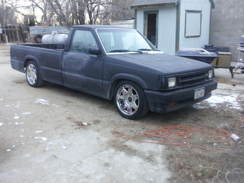

I have some 6 lug GMC wheels on my 89B2200.
tom_mcmullen
I'm running chrome Nissan pathfinder wheels on my 92. I know escalate wheels fit too.
fdugn545's avatar
fdugn545
I'm running 17 inch eskies, you will have to grind the tabs off of the rear hubs (u can bore the wheels) mine were already bored out when I got them.

it really depends on how low you plan to go. you can find some aftermarket wheels that will almost tuck or will just tuck in the front. a rearend swap is usually a must for a good wheel and if youre going that far into it you may as well do a 5lug swap. a common aftermarket wheel that guys are running are boss 330s in a 20" but i think you still need to run a courier or older mazda rear to make them fit perfectly in the rear.
