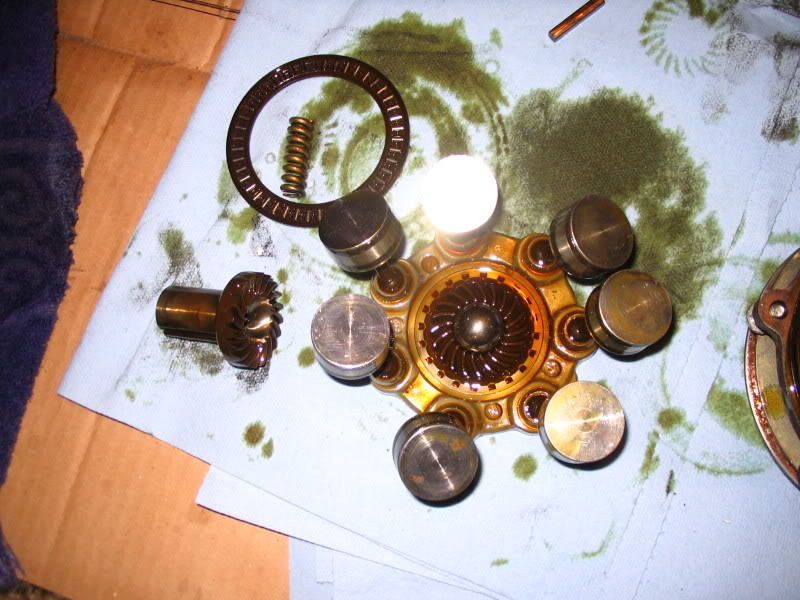

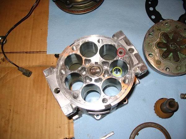

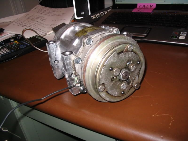

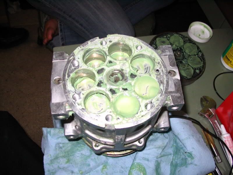

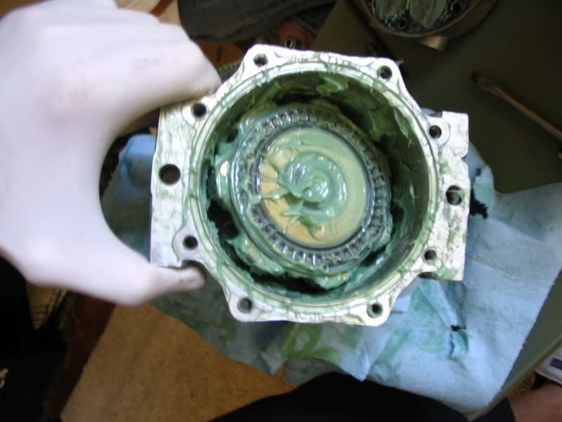

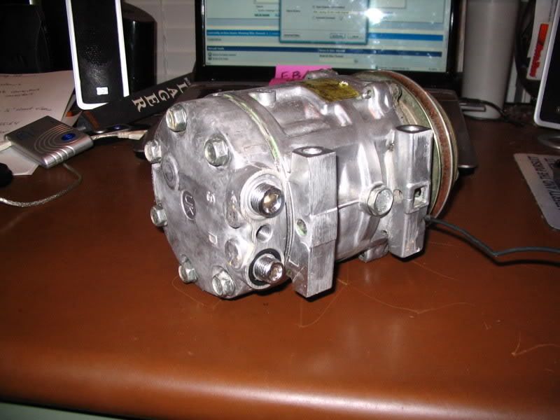

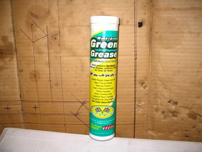

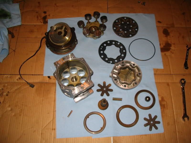

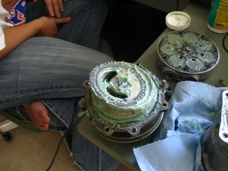

Hey guys, I figured I'd put up some pics and info bout this cuz It got put on my 92 Pup. . . Ok, first things first, the compressor is a Sanden 708. I took it apart and cleaned every bit of oil out of it. . . I cleaned all the parts off with gas to strip any residue from the oil off. The oil would deteriorate the grease so you have to get it all out. . . I used this stuff called "Green Grease." I got it from AutoZone. Its high performance, high pressure, high heat, resistant to moisture and seperating so it should be great for this. . . I've had the compressor converted for some time but I haven't used it yet. But since I bought this Pup, I want my train horns on it, so I am gonna use this as my compressor, pumpin my 2 3 gallon tanks. . . Well here's the pics of the conversion and makin the mounting bracket. . . Enjoy!

Well I got my horns installed. . . And I don't have a gauge yet but my buddy does. . . So i hooked my tanks to his. . so we totaled 18 gallons of air. . . My engine driven comp filled all 18 gallons to 200psi in right at 4 minutes!! I love it. . . It fills my 6 gallons so fast. . I have some leaks but I don;t even care cuz it fills it so fast haha. . . I'll fix the leaks once I get time

real quick noob question. what keeps the grease from going into the system like the oil would??
bodied b2600zx (josh)
its thicker and higher performance. . and grease is made to stay in place, unlike oils. . they are made to move around. . so the grease stays IN the compressor longer. . . It still pushes a little residual grease but thtat may slow down after its run for a while. . Cuz I packed it with alot of grease haha
88longbox's avatar
88longbox
ok so there will still be a little bit of blow through of the grease so someday you will have to repack it again??
