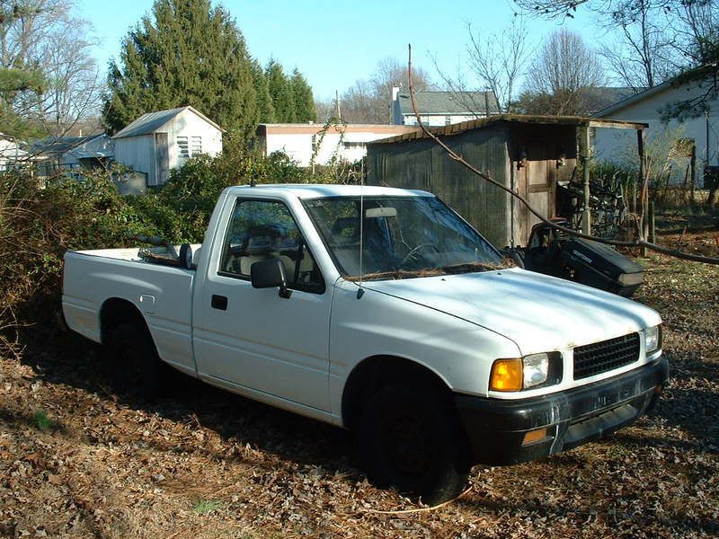

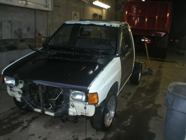

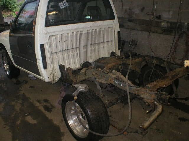

while im building my puparossa, i am also working on my crewcab and another project....a 90 shortbed pup with 240k miles on it.....

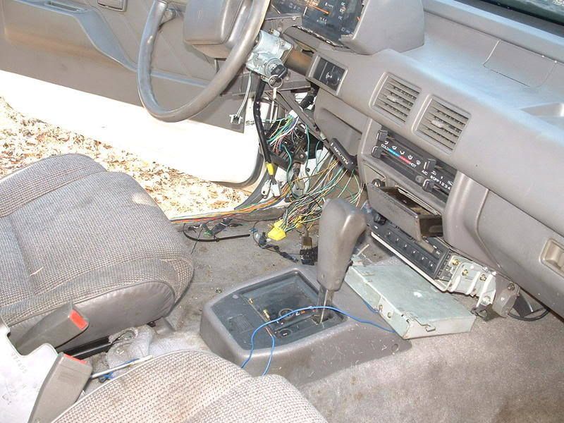

and it had major wiring issues...no run and the owner started cutting wires and testing.....yeah ugly, but a perfect canidate for this:

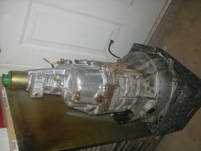

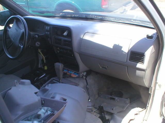

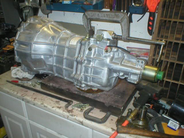

yup got a 96 Passport (Rodeo) and swapped over EVERYTHING. wiring harness, dash and all the stuff behind it as well....i cut out the frame section of the Passport, saving the chassis mounts for the motor. I bought a new OEM 0 mile 2.6L trans from a good friend in Georgia and swapped over a bellhousing from a manual v6 5 spd (passport was an auto):

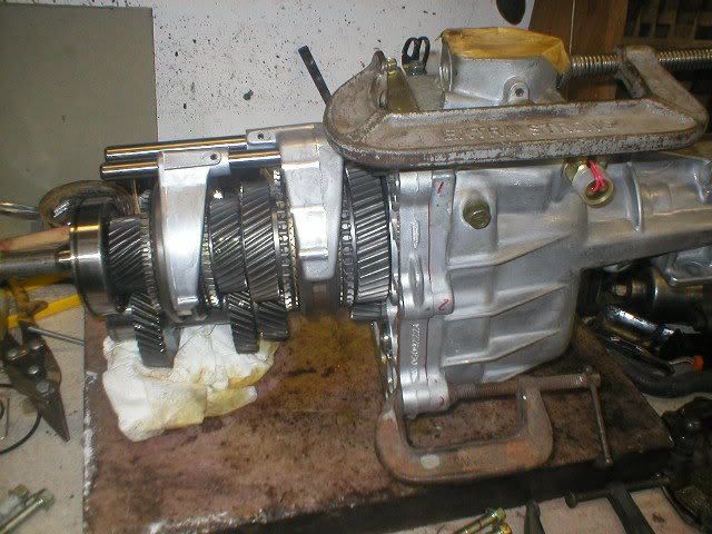

2.6L trans are the same internally

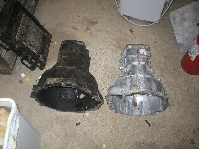

notice the bellhousing size difference...
bellhousing pressurewashed and installed:

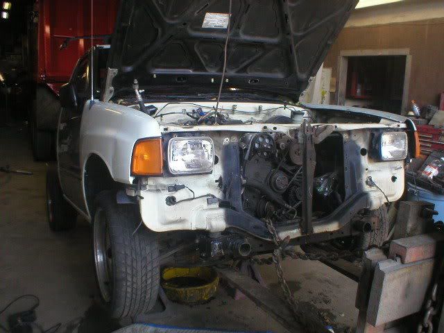

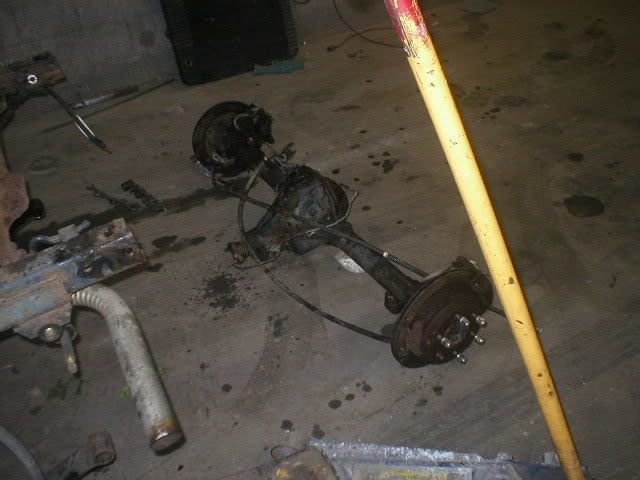

i put in a 94 Rodeo dana 44 also with a LSD center into the pup last saturday as well as ripping the 2.6L and auto trans out to make room for the V6:

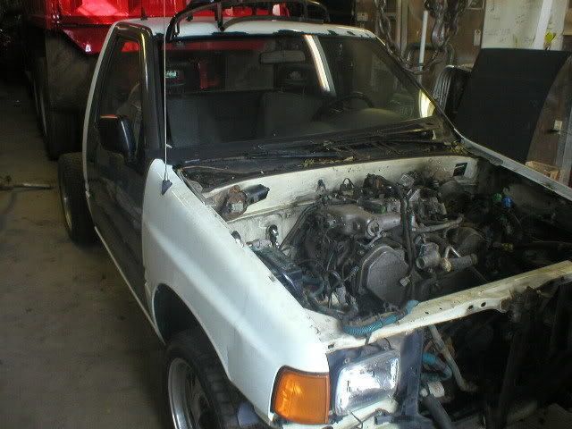

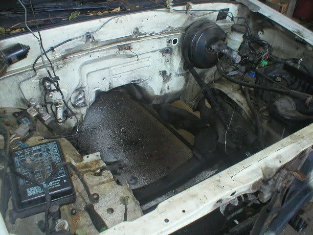

and the V6 sits REAL close to the factory I4 mounts but i have to swap in the others from the donor truck. i also have to change the fuel lines, ALL the brake lines in the engine bay, and the booster since the hose goes ina different direction. ALOT of interferrence issues but i have that 95.5 donor Rodeo (yeah 96 passport AND 95.5 Rodeo to do this swap) to grab the fuel stuff and brake stuff....all in due time.....well heres the V6 in the engine bay.
i hooked up alotof the wiring, got the doors to work (power windows) and most of the other stuff, no headlights or cranking of the motor yet...think the auto to manual swap is an issue...no neutral saftey hooked up...
