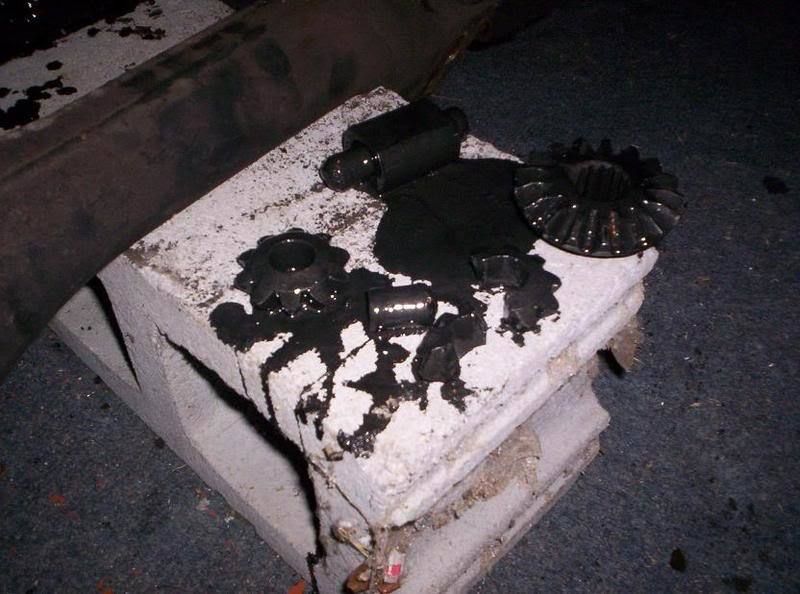

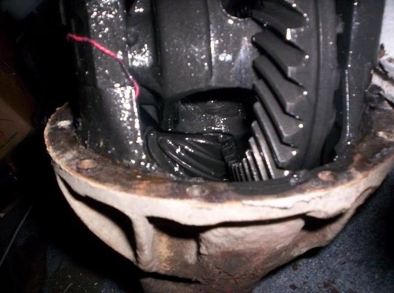

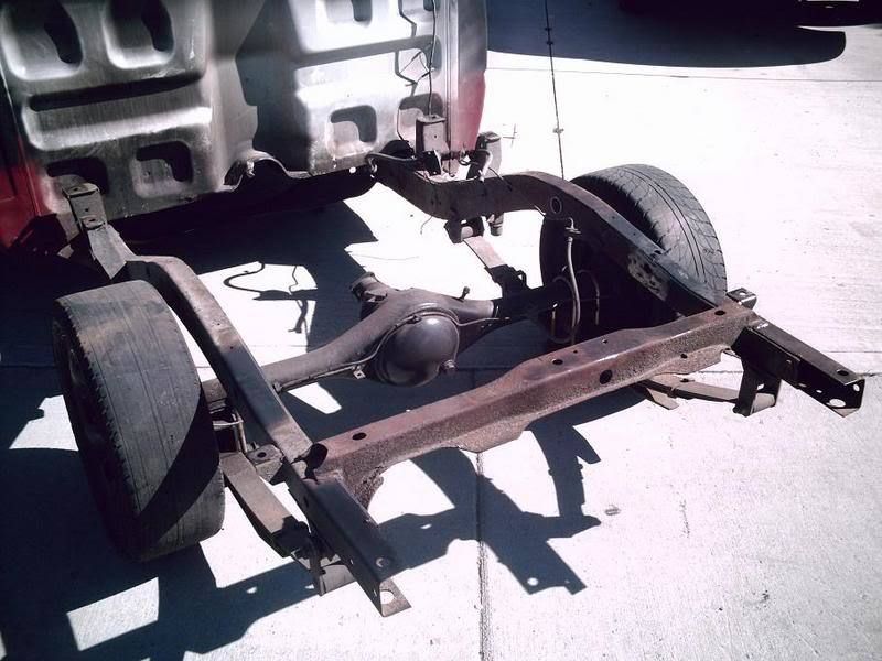

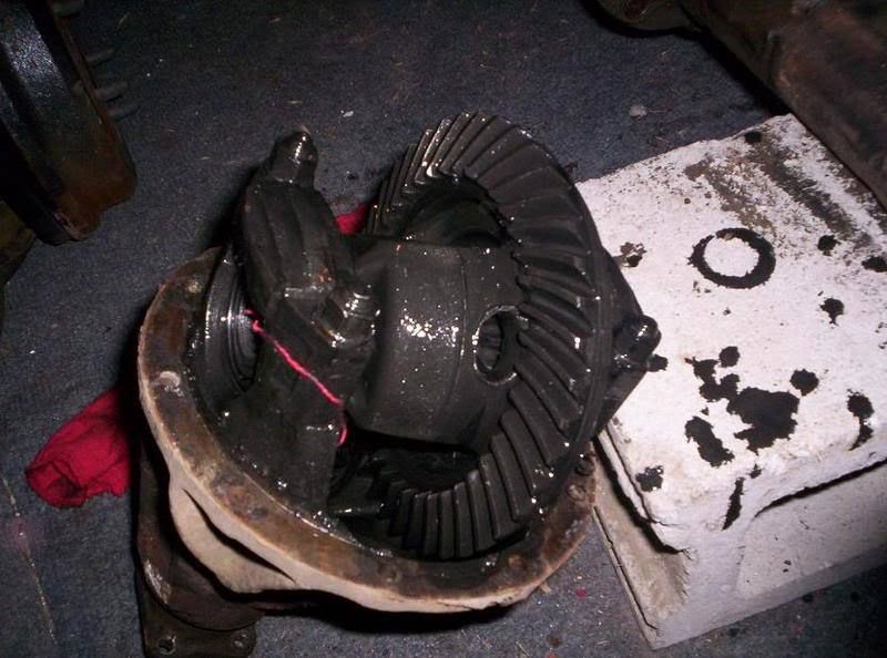

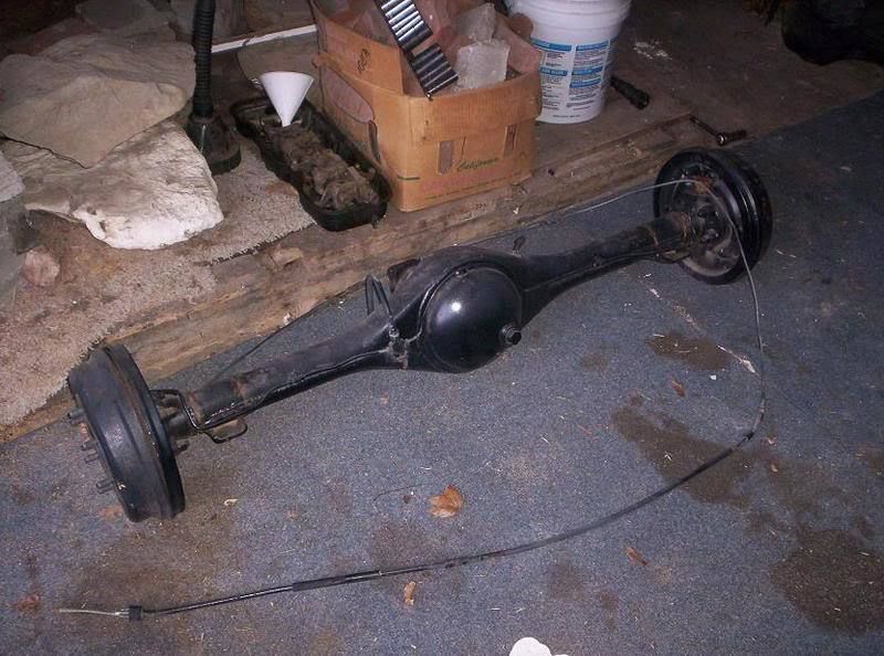

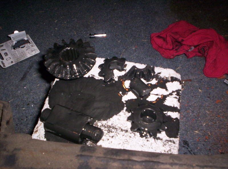

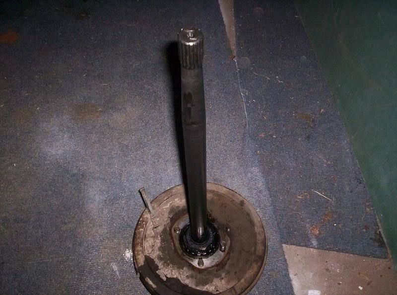

well i finally blew up another rearend, so its time to tear it down for the rebuild.
i ordered the re-ring w/ mains engine kit tonite. so i should be able to have the bottom end done by the beginning of next month. ive also gotta get a head rebuilt, and get a parts truck with a 5 speed in it.
im also going to be putting an s10 rearend in it for strength. this rearend i blew up is the second with this impulse motor. so its time for something a little stronger.

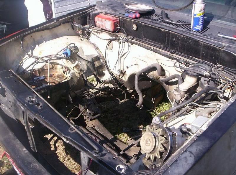

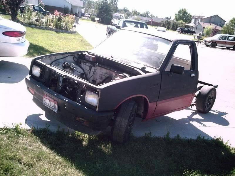

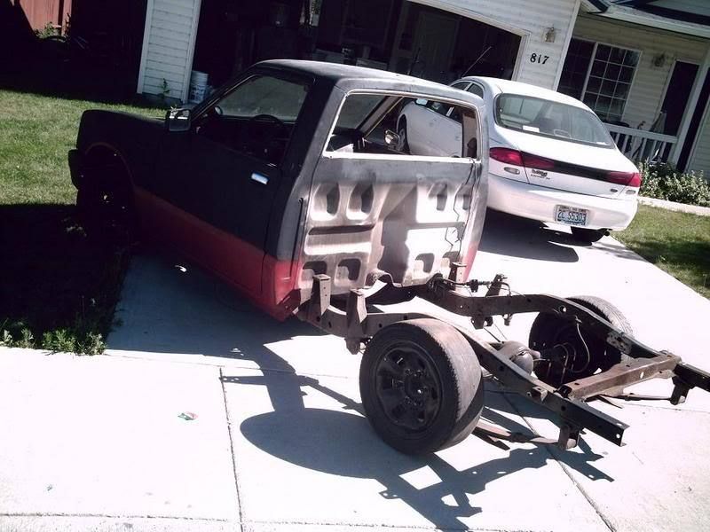

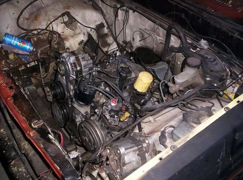

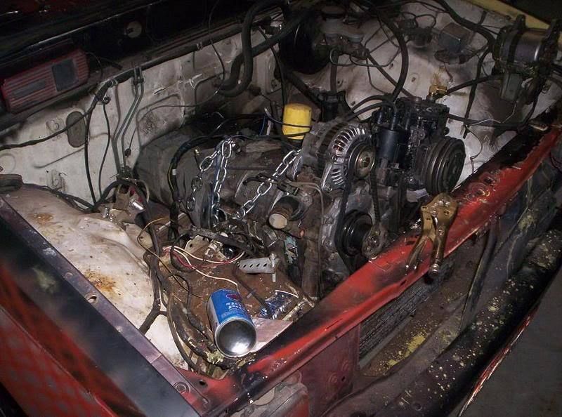

im gonna start pullin parts off the pup this week to put on the luv, so ill get some pics of the teardown.

yeah ill be sure to take lots of pictures. i should be startin on it next week once were done baggin my buddys luv.

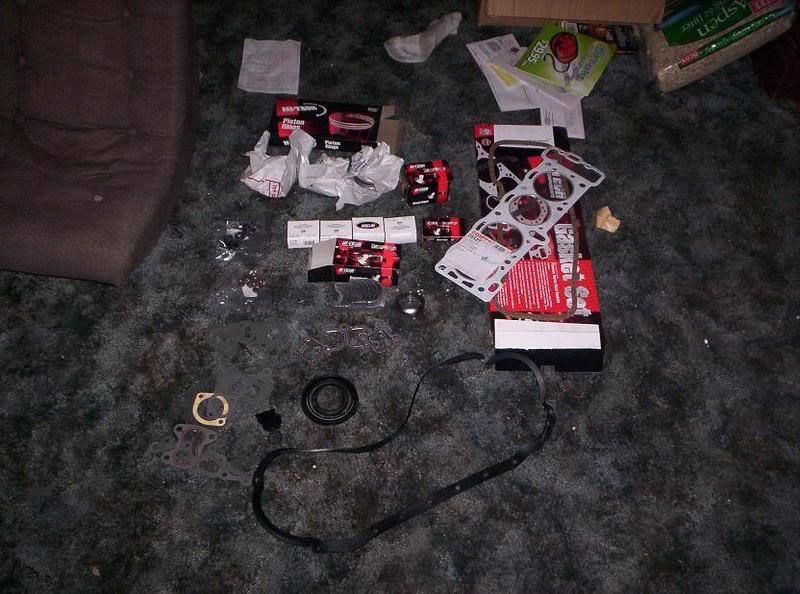

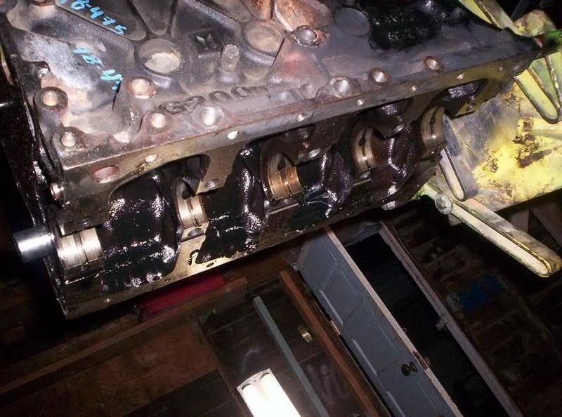

well i got the engine kit today. cost me 223bux. its a re-ring kit with mains. im gonna be tearin the truck apart next week hopefully so i can get the block and the head to the machine shop. gonna have them hot tanked, and the surfaces on the head and the block surfaced.
heres a pic of the engine kit...

hey man where did you pick up that engine kit???
farmer joe's avatar
farmer joe
got it at autozone for 223bux.
