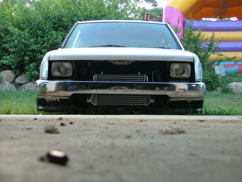

Welded up front bar.

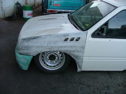

Side vents

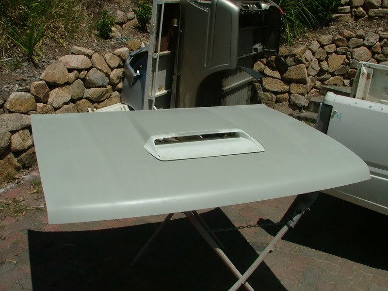

Hood finished

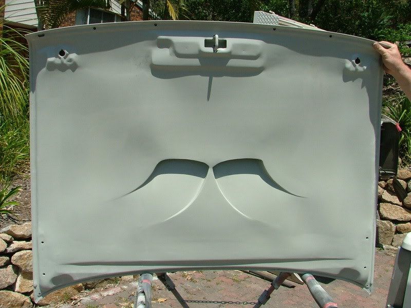

Underside of hood

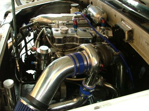

Engine
man that is looking awsome what are the details on the motor?
BT
ben thorne
Port and polished head with arp head studs, Heavy duty valve springs, custom inlet and turbo manifold. CP forged pistons, shot peened and lenshed rods. Balanced engine. I have a 50mm external gate, 4 550cc injectors and a GT3040 torbo. Front mount intercooler, blow off valve, Haltech ECU.
Thats pretty much it I think.
