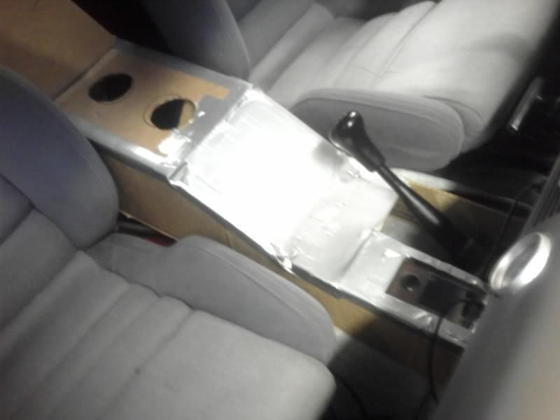

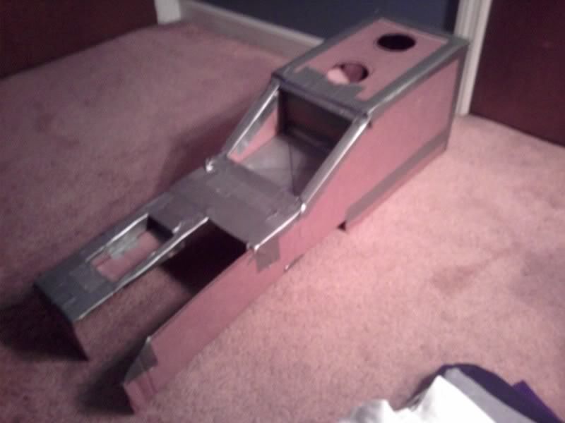

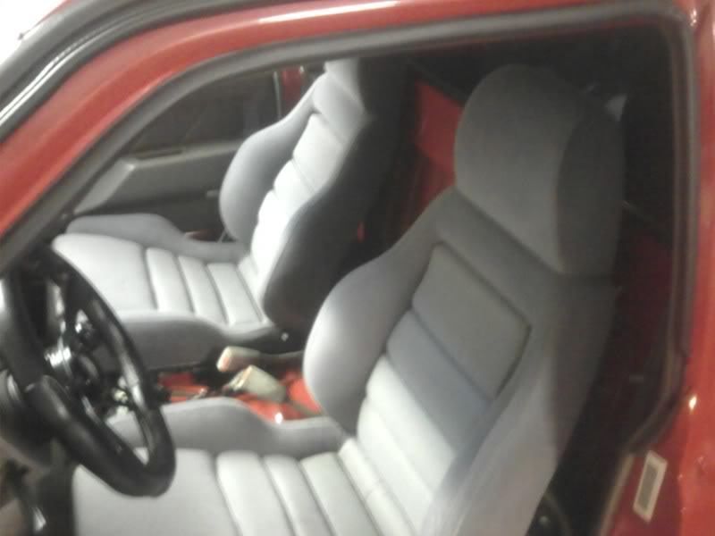

I got a really good deal on some jdm turbo2 rx7 bucket seats. Finally got one of them completely done. I also started making a model for a center console. Which i hope to start building soon.

nice. what all did you have to do to get them to fit?
lethalethan
to fit em i had to take 2 sets of isuzu bench seat rails. Drill 2 holes in order for them to mount to the rx7 seat. The seats mounting holes are the correct width for the stock isuzu bucket seat holes in the floor. then spacers had to be made to raise the outside rail up 1 3/4 inches.
I finalized my center console model. Hope to get some wood soon so i can start building.
