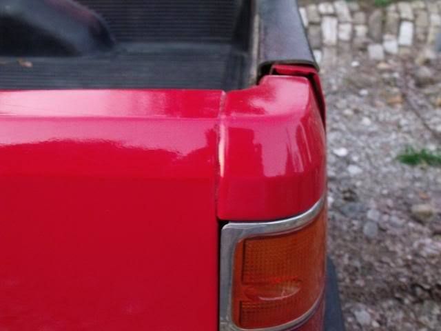

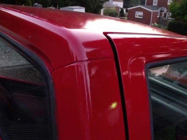

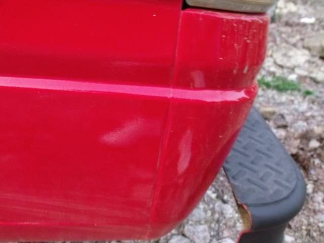

Has anyone shaved these body lines?
1148 views
2 replies
loudcherokee
Was wondering if anyone has shaved the body lines at the top of the cab and rear of the bed, for a smoother look. How did it turn out? These aren't flex points in the body are they? If you have shaved them, how did you do it?
LC
gldsuzi
pretty much every body shaves them, i havnt done mine yet and i dont know how other do them but i intend to weld them all up smooth them out and puddy them up
draggnisuzu
Yup I would weld them myself also. I welded mine when I started my first pup. They would crack on you if you don't weld them up.
