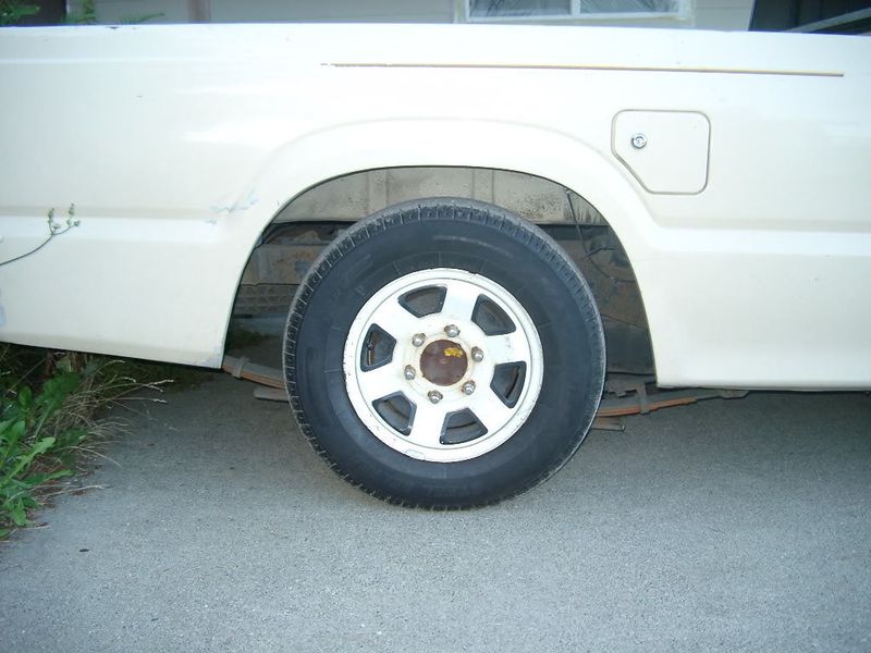

mazda86
Here is mine with 4 inch blocks and all the leaves still in. I didn't cut the bump stops off so there is only about an inch of clearence between the bumpstops and the frame.
